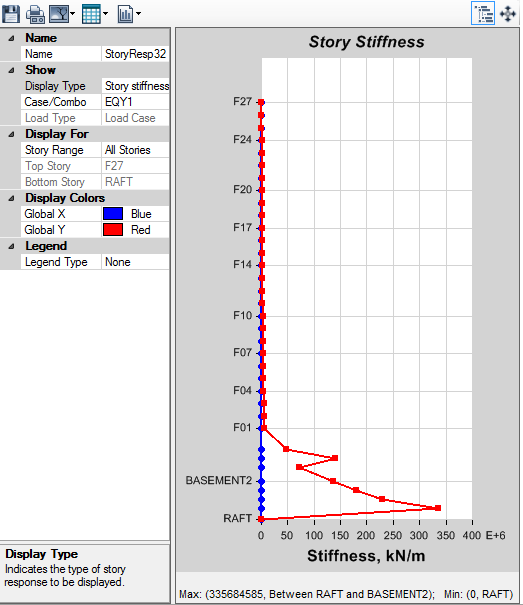

story shear along x and y direction might be different if you are performing dynamic analysis and the building has different  stiffness in different directions. are you performing static or dynamic analysis?
deflection in z is so large? how much large? is it like 50km? or just more than L/480? if its in km :P then support your nodes and check the model again. if its the second case, then stiffen the plates, beams, reduce loads etc.
period of mode is very high. again how much? if its like 20 seconds then support the nodes. one way to check is check deformed shape. if building is not deforming at all it means they are some nodes not properly modeled or connected. if T is more than 1s then the building is very flexible. what is the total height of building? stiffen the building by adding shear walls etc

upload a screenshot of seismic load cases data in both x and y directions here

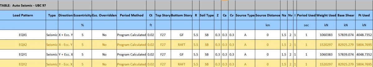

If you see tables of seismic calculations, you will notice period is 1s in each direction. Also story shear is same in x and y direction. Find the attached image of table.
base shear in EQ1x and EQ1y is same.
also base in x and y directions of EQ2 is same.
but EQ1 and EQ2 are different from each other because of difference in story range. You can check this in tables of your model.
I dont know if you are producing results from a different model than what you have posted here. I am getting the same results again and again in both directions.
for example see the attached image.
there is now live or sdl load applied in the model although included in mass source. also there are some warning while running the analysis.
