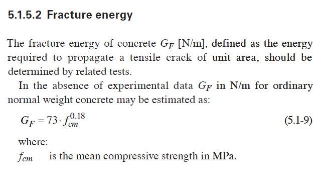

If concrete fc'=17.82 MPa, is there any relation from which I can find its fracture energy?
I have seen CEB-FIP codes, they give the fracture energy with respect to aggregate sizes. I dont have aggregate size for my concrete. Now when I am doing finite element modelling, so I require fracture energy. Is there any approx. values of fracture energy with respect to concrete strength?
Thank you
Following link, from fib bulletin 70, gives a relation between fracture energy and compressive strength of normal weight concrete:
https://books.google.com.pk/books?id=zArcAwAAQBAJ&pg=PA18&lpg=PA18&dq=relation+between+Fracture+Energy+and+compressive+strength+of+Concrete&source=bl&ots=8mC5UGh1Pz&sig=YDt2HkAYeVFHW-VLLZeipmnKu5U&hl=en&sa=X&redir_esc=y#v=onepage&q=relation%20between%20Fracture%20Energy%20and%20compressive%20strength%20of%20Concrete&f=false
This relation also requires 'maximum size of aggregate', for which you can assume a suitable value, keeping in view common practice of the area / locality, your concrete belongs to.
