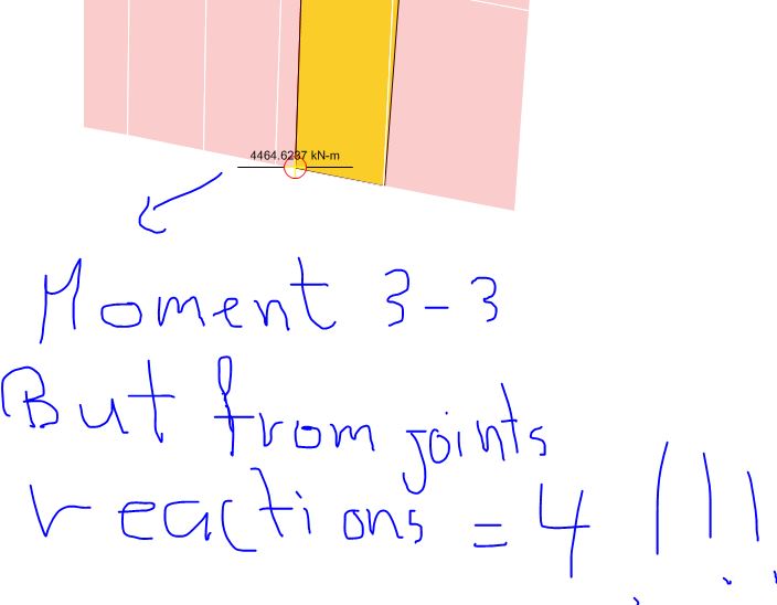

how to see the reactions under shear wall:
1. if we go to show reactions command we will get joint reactions but if I make summation for them they will be illogical values and too much little values especially for moment reactions.
2. If we go to show pier forces we will see the internal forces of that shear wall which shows a realistic values then we can read that forces at the bottom of the pier then what we got is the reactions on the foundation (Am I right? If yes, then why ETABS gives wrong values in point #1)?

thanks for following up first. The wall has 5 supports and meshed.
Shaker,
I haven't done walls in years so I am rusty on that. You are right regarding point 2(stated by you) but you need to make sure that for a wall, all piers have same label. Then the forces are reported together.

Dear Shaker,
ETABS joints reaction are just for the points that are manually meshed. That is the reason if you export your ETABS model to SAFE you will see far more points than that you see in ETABS Model. These are internal meshed points due to automatic meshing.
You can always use the pier axial force to design footing.
