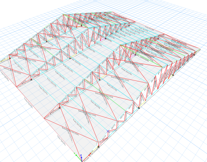

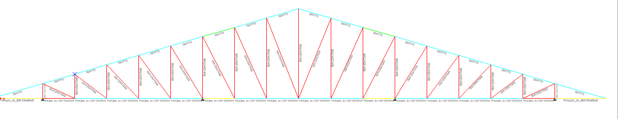

Thank you very much sir. I have another problem. I'm modelling steel for the first time, could you help on that also. The span of truss 19.15m *19.15m and I'm trying to model it. Sir, is there any document related to modelling of truss in ETABS. I'm following Indian Standard for design. This is my first attempt and most of the members failed. Thanks. :)
You are welcome. Simplest way to learn something new to model is to take an example out of the book, do the model and compare the results. If your results are same as that of the book example, you have done a good job.
Here are some tips:
1) Top and bottom members need to be modelled and designed as continuous members.
2) Make sure your unbraced lengths are correct.
3) Manually resolve wind and snow loads on trusses. In that way, you will minimize any chances of error in load application.
4) Manually check at least dead weight reactions and member forces. If they match, you can trust your model.
Hope that helps.

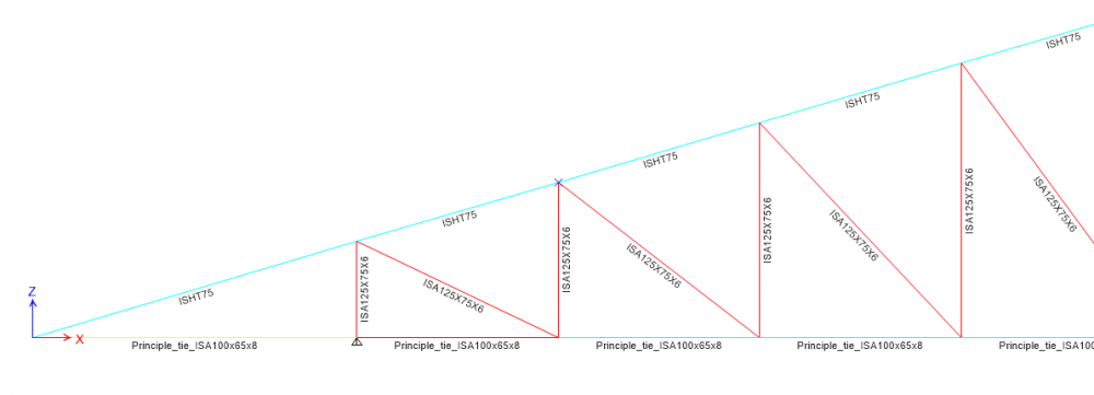

Umar I face problems in design of trusses after analysis.
As roof trusses are subjected to both wind and snow load also pitching is done on roof, so they are likely to be analyzed for line loads. Analyzing for line loads mean that they would have both bending moments and axial forces. Also for studs, compressive strength is a function of length (tendency to buckle which reduces the strength). How to do design then?
Should it be like to use the interaction equation or unity check for combined loads with axial capacity incase of stud being calculated as a function of length, adding them up and the product of summation should be less than or equal to 1?
Depends how the corrugated sheets are connected to roof. If your roof sheating is connected through purlins  to roof then it is a concentrated load.
If you have moment, then yes. Use interaction.
