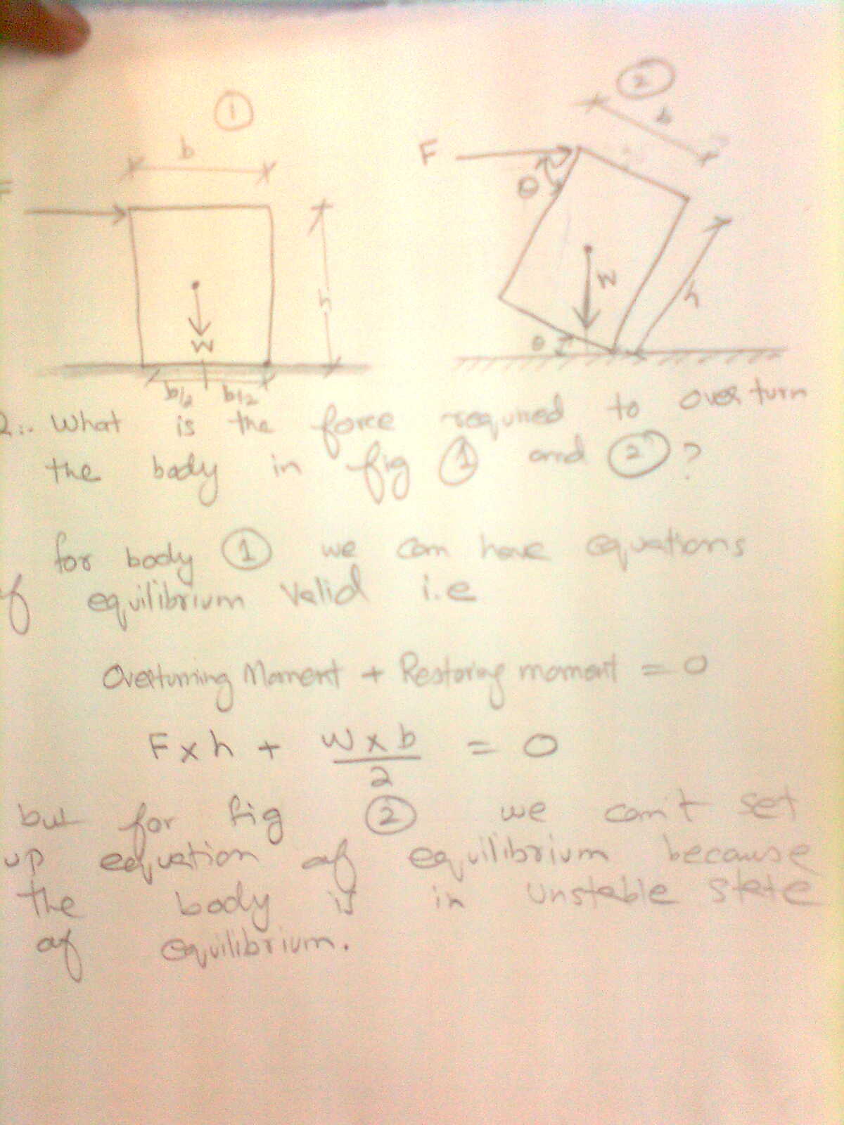

for the first figure
in equilibrium equation the two moments will have different signs as F force is trying to revolve the object +CW and W weight is trying to satbilize that so it will be -CW,and O.T.M = F.h - W.b/2 the difference will be the over turning moment ...

YEAH ITS OBVIOUS...
the question is how much force is now required at this stage to over turn the structure...
You have provided answer in attached photos. In every structural engineering we develop mathematical relations with describes the real structure and those equations are solved for equilibrium.
If you are not sure as to how you will mathematically formulate this simple problem of statics , then you have a long long way to go in this field.

in the second fig the object is unstable when F is removed if F is applied continuously and depends on F, W and theta also it is the intermediate stage of fig one during the application of force and overturning,theta be greater than 45 degrees the object will not come back suppose object is in equilibrium and there is enough force F and you are able to set object in the condition it is and you can increase the force F gradually, making an equilibrium condition for the object in fig 2 and substituting theta slightly greater than 45 will give the overturning moment.
