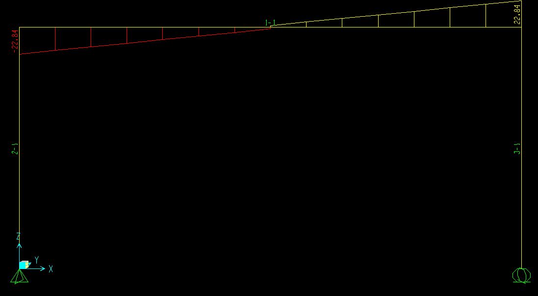

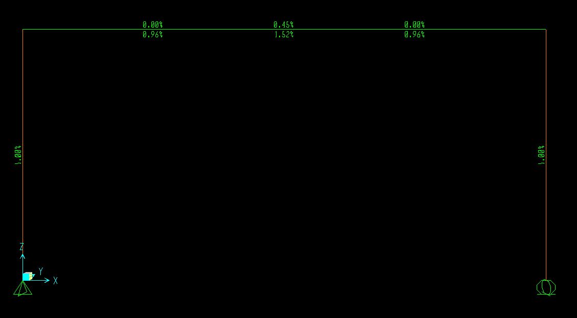

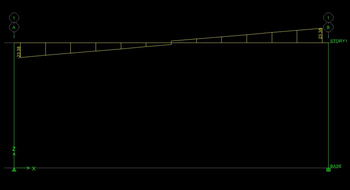

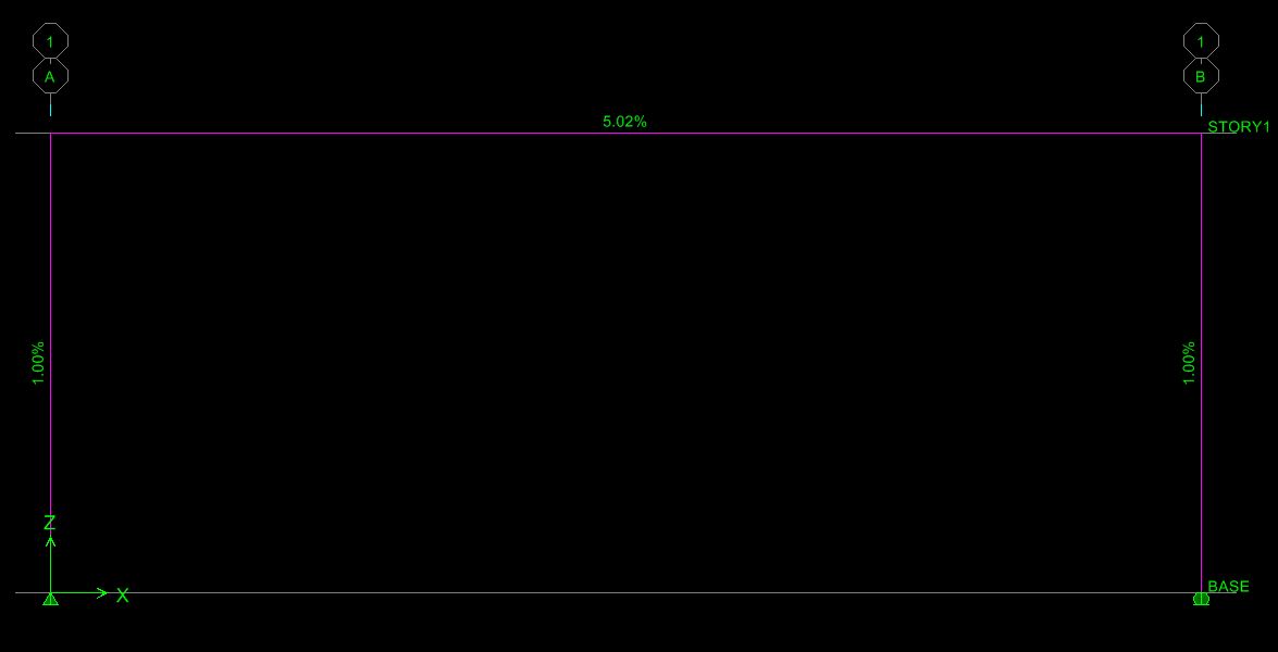

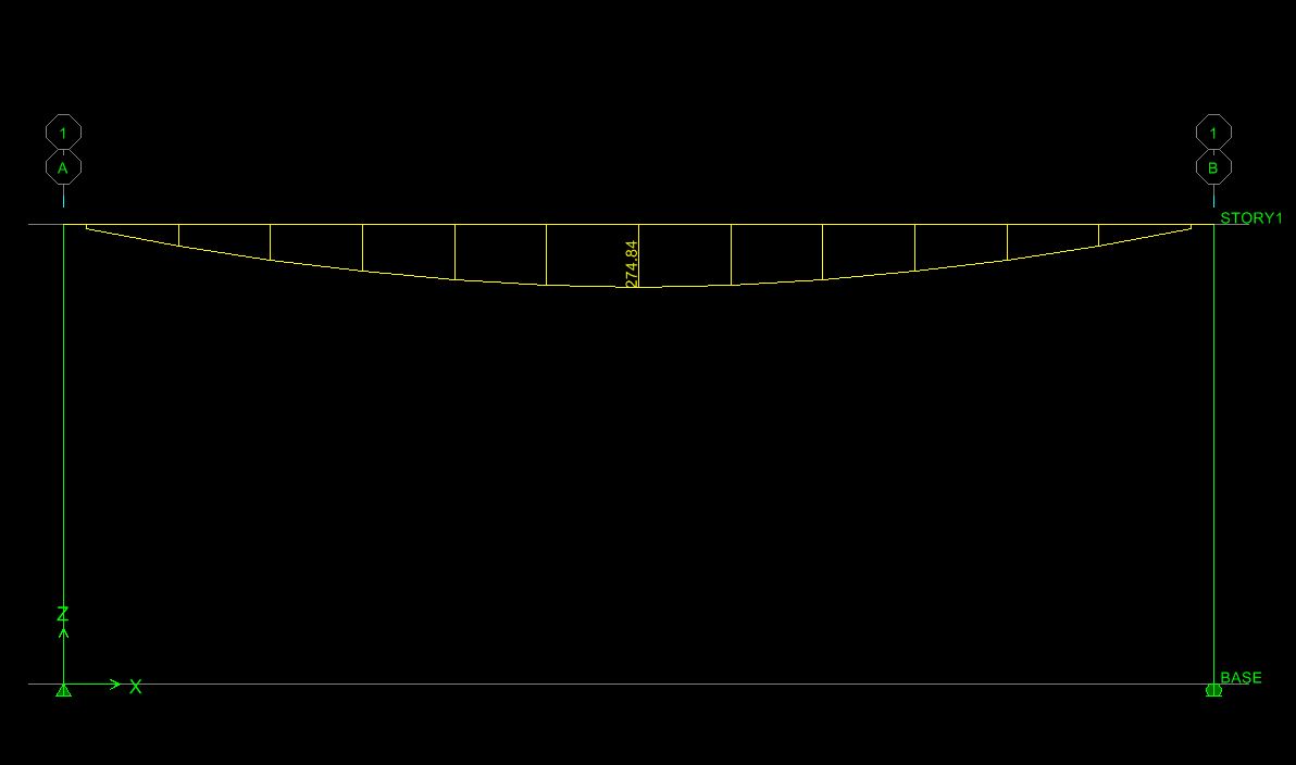

i have a simple frame with single span 25' beam(12x18) supported by 2columns(12x12).loads on beam are 2k point load at the centre,500lb/ft uniform live load and 1000 lb/ft uniform dead load.columns are having same 1% reinforcement in both but beam shows 5.30% in Etabs and 1.52% in Sap2000.fc' for beam is 3000psi and for columns 4000psi.preferences are set to ACI318/IBC 2003. i couldn't upload the files ,on attaching "your are not permitted to upload this kind of file.

here are the images for both etabs v9.7.1 and sap2000 v14.
there is difference in shear values i used default load combinations.

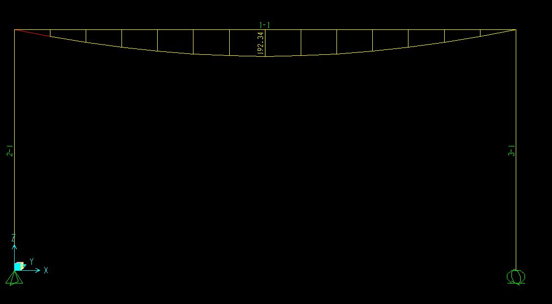

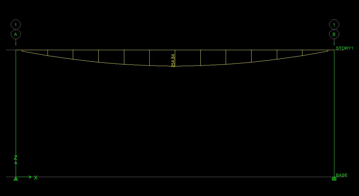

moments are different .i guess there is some problem with my load combination.i chekd the moments for defing my own combination .i defined the combination 1.2D+1.6L for both.moments are 192k-ft and 274k-ft in Sap2000 and Etabs respectively.
I did a quick manual check. Moment is 195 k-ft consider the 2k load at midspan is a dead load. There is something wrong with the 274kft model input. You can make another model for comparison and just apply UDL loading only to see comparison or point load only to see comparison. Both results should be same as what you manually calculate. Have a look at your reactions.
just look at the pictures posted by you, its evident that in ETABS you did not specify the end offsets. In ETABS (look at the moment diagram) moments are reported at the face of support. In your example moment of beam is reported at the face of column, while in sap to the centerline of column.
If you want to compare then in ETABS select the lines and make their offsets = 0
