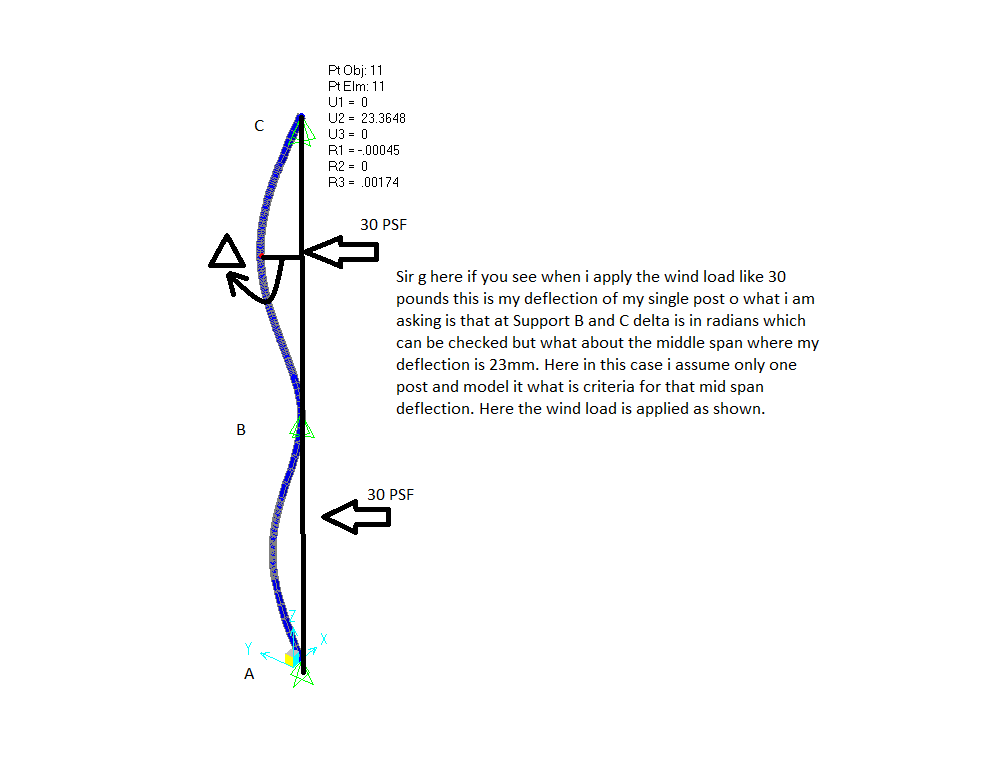

Sir g please have look at these what is wrong and where...all the deflection criteria which are available or i have seen give us or tell us about the end deflection only. Slenderness and buickling is only one thing which t=is there to chk the element but what about this what i as asking, and if i am wrong please do correct me.
Yasir, like posted above the max midspan for element is controlled by the maximum deflection acceptable at that point by attached non structural member. What I cann't understand is that why are you checking max deflection at midspan when your checker is asking you to satisfy interms of story drifts?

For a non-structural member attached as cladding, unless limits or drifits are specified by vendor brochure, you are left with wind code provided limits only as your criteria. You also need to make sure that your wind loads are reasonable. Your loading looks high to me. Plus your are looking at displacements where as limits are imposed for drifts. As long as you are satisfying code specified criteria your checker cant say anything, i still think he wants you to do what I posted above in the pdf.

I think that strength and serviceability limits should be satisfied for these non-structural members, independently of main structural system. It is the mid span deflection due to wind load that also needs attention.

sir thanx for the detail comment i was going to write some of your concerns about the limits that sir umer shared above these are there when gravity load or point load is acting and drift the consultant concern for these posts is midspan deflection due to wind load how much they will deflect and what is limit.
