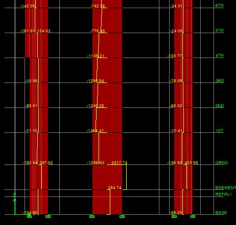

I have attached snapshots of the distribution of shear force in walls at two different grid lines. Totale base shear of the building is 2600 kipps, and total shear force carried by walls at the ground level is more than twice the base shear.
In base shear calculations hight of the structure is what is above ground, also called Tn. Sir, what if you try the same model with your base supports at ground level and all basement levels deleted. Do you get the same distribution ?
I get different distribution. The question is why am I getting the distribution in this case. Should anyone proportion members for the design forces given by ETABS in stiffer portion? They are too much. An if I increase the stiffness of lower portion, forces keep on increasing. Is it not a violation of equilibrium, forces are much more than what superstructure can transfer.
I have also assigned base level to be at top of basement.
Sir, are you doing a modal analysis? If you make your structure stiffer the seismic force would increase in that case. As smaller the T, the bigger the force
Also, do you get a constant distribution of base shear when for stories below ground when you specify your lowest level in ETABS load case to be ground?
It may be a bit off topic to discussion, but I would still like to share. I found this article related to assigning base level for seismic computation. Check here: http://www.sepakistan.com/topic/1448-location-of-base-for-seismic-design/?p=3151
With reference to above linked article, the recommendation in such a case would be to have the building analyzed using two staged Equivalent Lateral Force Procedure as per Section 12.2.3.1 of ASCE/ SEI 7-05 Or using Response Spectrum Analysis.
If you use Response Spectrum Analysis(RSA) in ETABS, you may have to still keep and use the ELF load cases for foundation design, as signs would be lost after RSA. However a 25% reduction for overturning moment for ELF cases as per ASCE Chapter 12 could be used to massage the situation.
