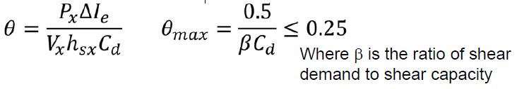

5) Stability is satisfied by requiring the seismic-load-resisting system to have sufficient strength and stiffness to ensure that second order effects are not significant. Second order check is performed. See equation below.
This ensures that even under large seismic displacements, we have sufficient ability to resist seismic load.
When doing your structural analysis to code/ ASCE 7, you are indirectly striving to achieve integrity that would satisfy much higher forces than what you have designed for. The above points just provide summary of some of the checks built in the code to ensure that.
