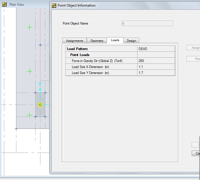

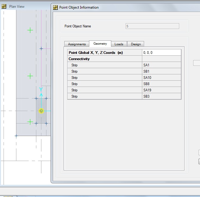

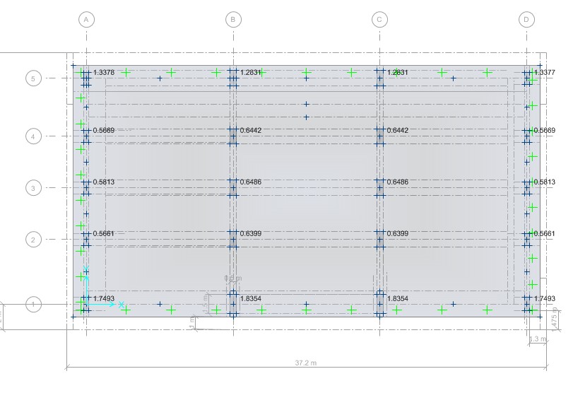

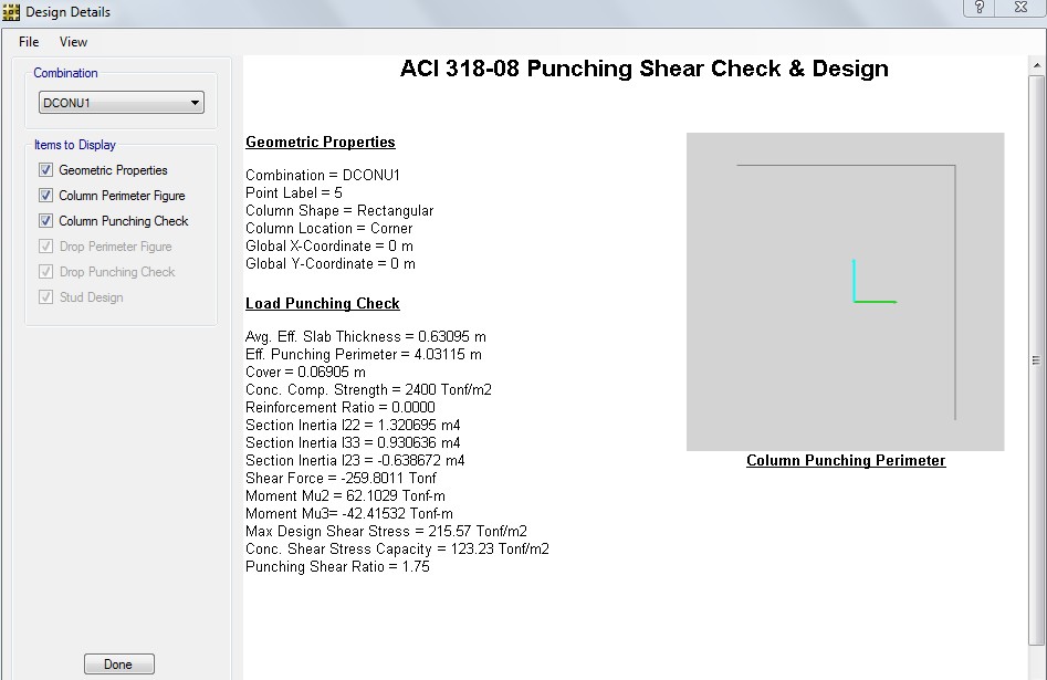

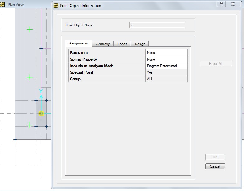

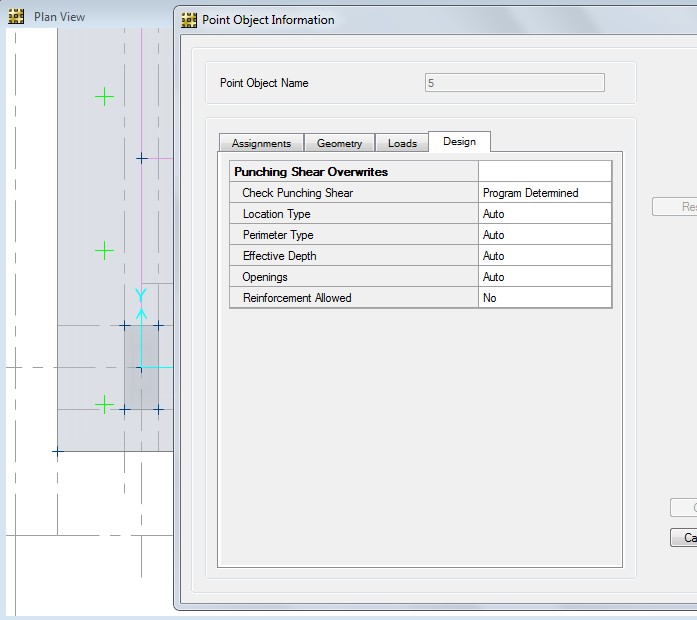

Thanks uzair bhai... here it is plz reply me the dimension of one span is 11.4 m along x-axis and 4m along Y-axis....all are rectangular columns..design need for raft? periphery columns having punching problem.

Calculations are okay. You are calculating punching as corner columns. So you end up with less bo. For edge columns you should select edge columns while calculating punching.
Either increase the raft thickness or column size or try reducing moments at edge/corner columns by changing the system or may be all of these three options. At the end you need more bo.d.
