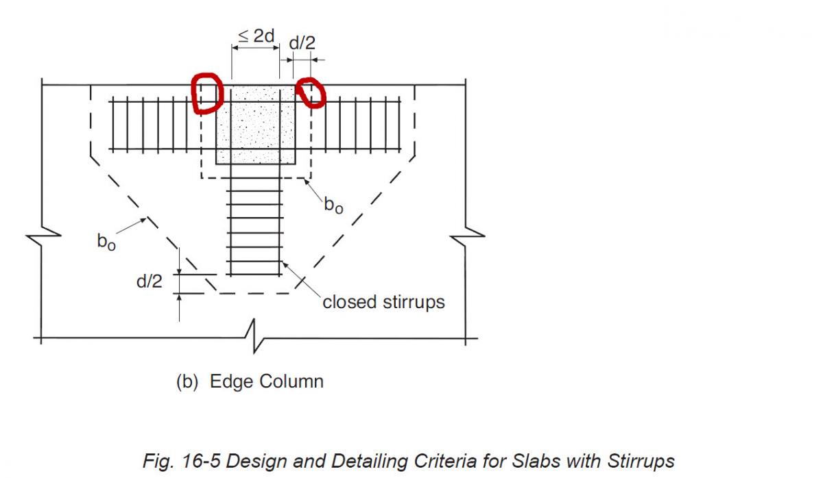

Okay! SAFE is doing it perfectly. See PCA Notes Fig 16-5 "Edge column" (see attachment).
Include the marked dotted area also in calculating punching perimeter. Hope that clears your confusions?

Thank you. But I am not talking about what you attached. My case is that there is a distance behind an edge column less than 4*depth of slab( I mean not as perfect case which is =0 as you attached). Now this distance shall be taken only = d/2; not all the distance. This is shown in the following topic Figure3 b http://docslide.us/documents/design-for-punching-shear-strength-with-aci-318-95.html. Note that how that he didnt take the whole distance because it shall be ignored.
