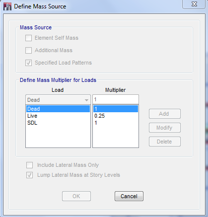

Mass source is used for determining the effective seismic weight of the structure for calculating the Seismic Base Shear. Below is the snap shot of ASCE7-05 definition.
 post-1754-0-55179600-1429636561_thumb.pn
In Etabs you will have three options. Not to confuse You should do one of the following NOT both:
1) From loads only
    Dead
    Superdead
    Live
1) From specified mass and loads
    Superdead
    Live
If you put your Dead load in as a load to be considered and you still count your specified mass you will have your DL be twice.
post-1754-0-98563300-1429636746_thumb.pn
Batoul what you did in mass source is perfectly okay but you dont have any sdl or live load applied in model. so recheck. rest i have told you that the base shear is same in both directions if you check from tables. dont worry too much abt it.
