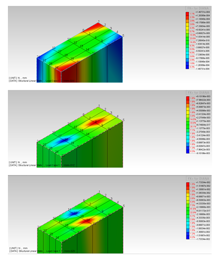

I made a column that is fixed at one end and free on the other end. When I apply an axial compressive load on it. It gives the shear stresses i.e SXY, SYZ and SZX.
Why it shows shear stresses when there is only axial load at centroid of the cross section?
*Attached is the file showing the shear stresses sxy, syz and szx
post-2274-0-50224300-1433842192_thumb.pn
no it give shear stresses at the free end where i applied the axial load.
i have selected all the nodes and applied fixed end conditions on each node at the bottom of the column.
the attached picture showing whole model having fixed supports at bottom. shear stress SXY is also shown as contours
post-2274-0-75556600-1433910422_thumb.pn
and how did u apply the axial load? as a point load on a node?
if as a point load, then yeah the column will exp some (fake) shear stresses because in reality there is no point load, it should be uniformly distributed on the top surface of this column mesh (remember to reduce load to half on edge nodes, read about consistent vs lumped loads in FEA). Are you using 3d brick elements for the mesh?
After doing this, you also need to turn of poissons ratio effect if there is any. Make v=0 and then all shear stresses should be zero.
