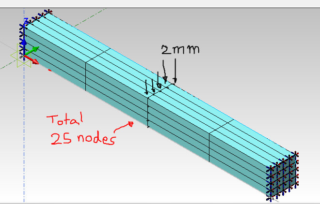

How to assign the displacement in the centre of 3D solid beam?
If i have to put 2mm displacement and at centre i have 25nodes so should i put at centre node the displacement value or should i put the displacement value on all nodes??
e.g for load of 25N, I divide it to 25 nodes and assign each node 1N load. Should I do the same for displacement?
*Attach is the picture of beam
post-2274-0-43691400-1436846987_thumb.pn
IMO, the displacement should be applied to the nodes, located at the neutral axis level. If you are studying the effect of displacement normal to the horizontal plane, considering the beam  as a linear member only, the displacement should be applied to all the nodes at NA level. Otherwise, displacement may be applied to one node at a time only.
Displacement value should, of course, be 2 mm for each node.
