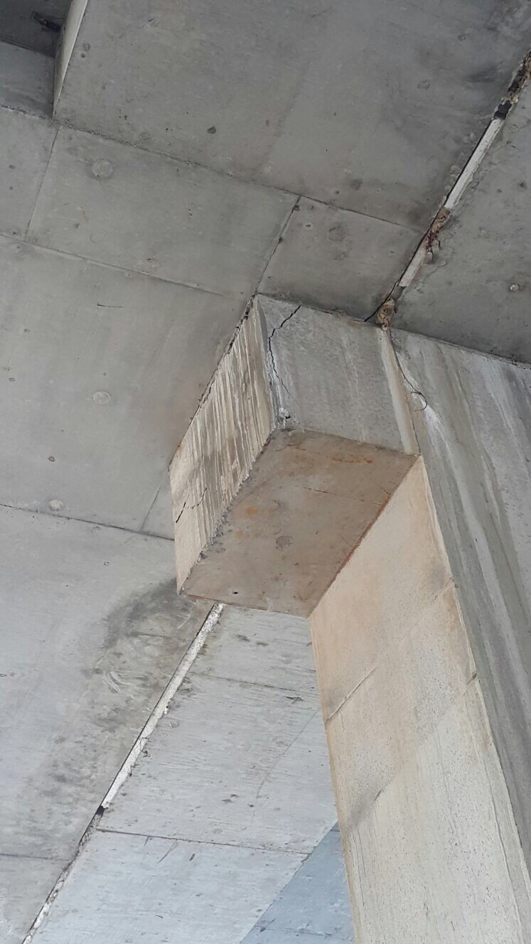

A structure was provided expansion/seismic joint at a distance of about 200ft. It is normal practice to do that. But normally, two columns are provided at the joint to suport end-spans. But, in this case, the end panel was supported on corbel which was attached to the column loacated next to exapnsion/contraction joint.
Floors of the building contracted, approximately,  4 months after the pour. post-6-0-65608300-1448554073_thumb.jpg
This resulted in the damage of corbel, or the beams supported on corbel. Damage to two corbels was limited to the spalling of concrete, as depicted in attached pictures.post-6-0-60497200-1448554205_thumb.jpgpost-6-0-51354000-1448554237_thumb.jpg
In two joints, end of beams also cracked along with the corbel.post-6-0-83218800-1448554456_thumb.jpg
