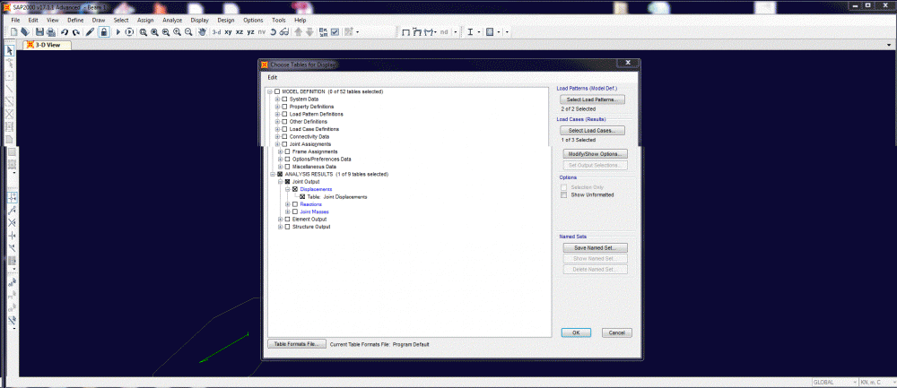

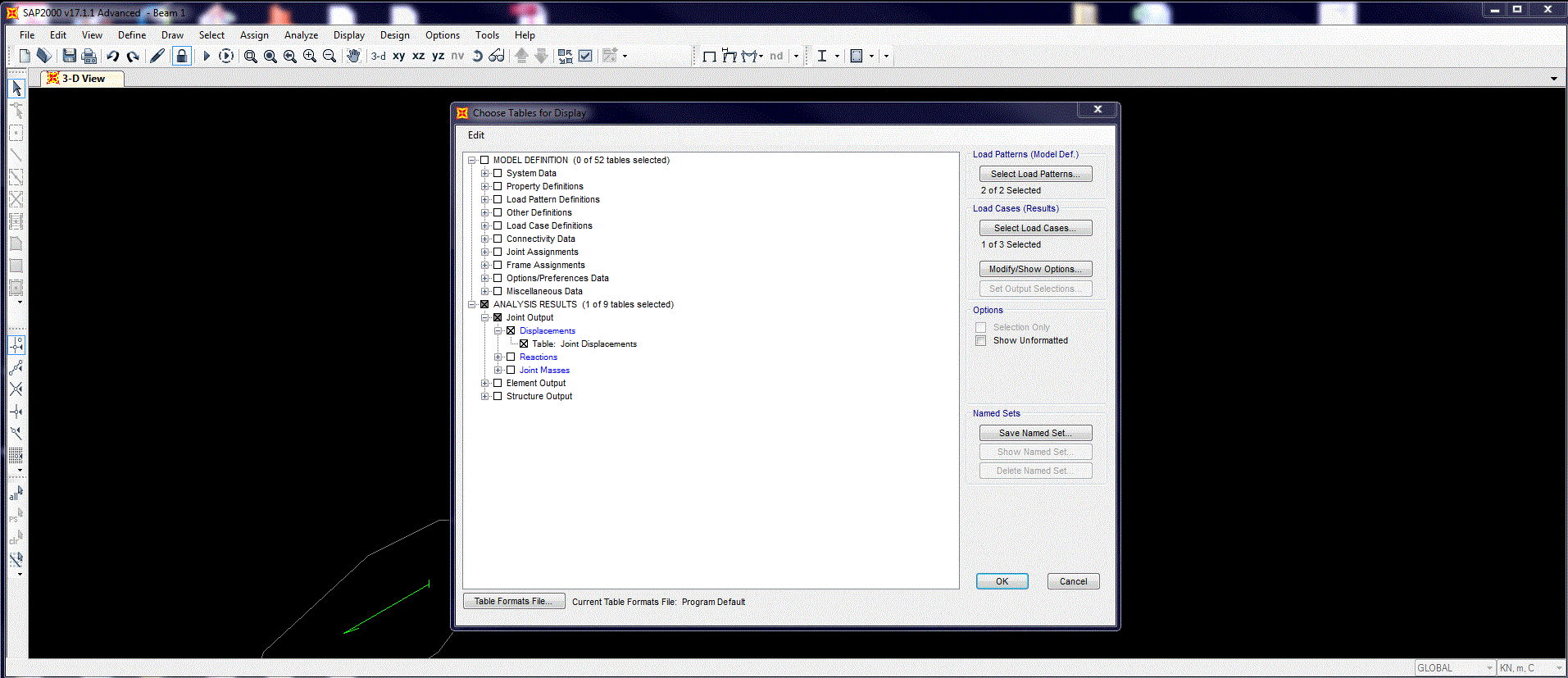

After analysis of multi storey building in etabs,i want to find deflection for each beam but it's too time consuming to check deflection for each beam individually.There is no options in tables for beam deflection in Etabs .How i will obtain it in table format so that i can work on it in excel.
One way of doing it is to assign joints at all beams centre. After analysis is complete you can go to Analysis output and report joint displacement for load case you are interested. It will give you a table that you can either copy to excel or export as an excel file. See attached for SAP2000.
