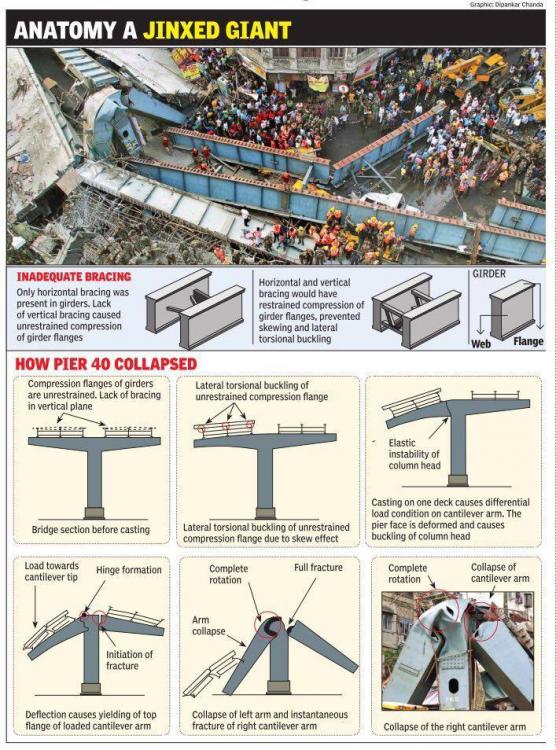

Here is an updated infographic that I came across today. Looks like failure occurred due to lateral torsional buckling. The girders compression flange lacked support.
