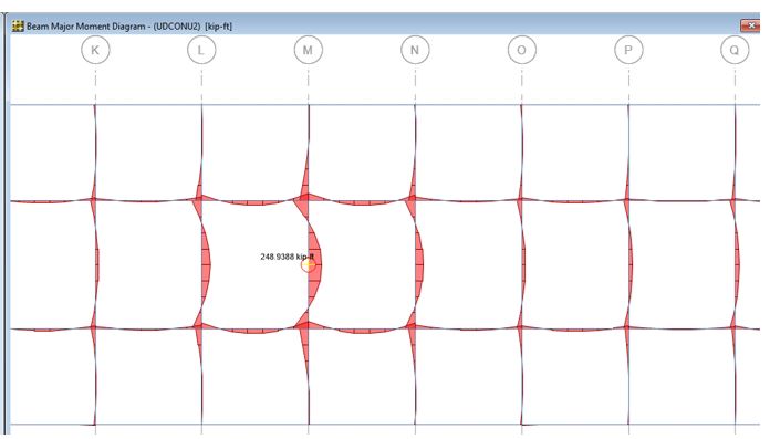

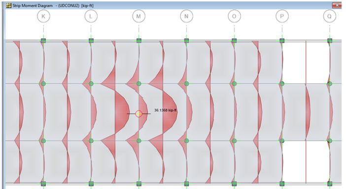

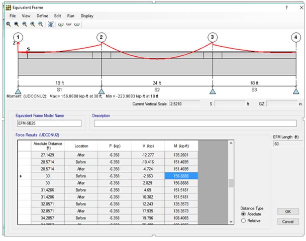

AOA, I have been trying to figure out why strip moments (last figure) are so low compared to either beam moments or the equivalent frame method moments (2nd figure). I also checked the strip moments manually using equivalent frame method technique but the moments were way higher than the 36 Kft shown  in strip moment diagram. Am i modelling the design strips wrong here??

I am talking about the span in Grid M. only the interior spans LM and MN were loaded with live load while dead load was uniform on all spans. I did this to obtain maximum positive moment on interior column strip at grid M. However, the strip moments being displayed are too low to make sense.

After hours of miserable pondering I came up with this lol. Correct me if I am wrong.
The strip moments are shown only for the slab portion of the slab minus the beam moments. Summing up the beam and strip moments will give us the equivalent of column strip moments that we obtain through typical manual equivalent frame analysis. For middle strip, the moments are obviously for the slab only since no beam is present.
@UmarMakhzumi Well cant say for sure whats happening here. But middle strip moments match with the manual results. For column strip, the software mid beam moments are still higher than manual. manual gives 151kft and the software value is 248kft. However, when I apply stiffness modifiers to beams and columns (0.35 and 0.7) respectively, the beam moment drops to around 209kft but still appreciably greater than manual.  @Rana Waseem what do you think is the issue here? @UmarMakhzumi umar bhai how do you evaluate slab and beam moments for two way slabs? like what is your take on this?

Ofc SAFE strip forces will be different than those from manual method because of differences in strip widths. What is the strip width in SAFE vs in ACI or whatever method you are using? Also try changing slab from shell to membrane after you have done the above point.
AOA @Rana Waseem. Thanks for your reply. Well, the strip width in safe was the same as in ACI i.e 1/4th the span on both left and right of column centre line. This was program default but I confirmed the 1/4th rule by checking up strip geometry menu. I am guessing the issue is because SAFE is probably only displaying the slab moment minus the beam moment for column strip.  Is this true?
