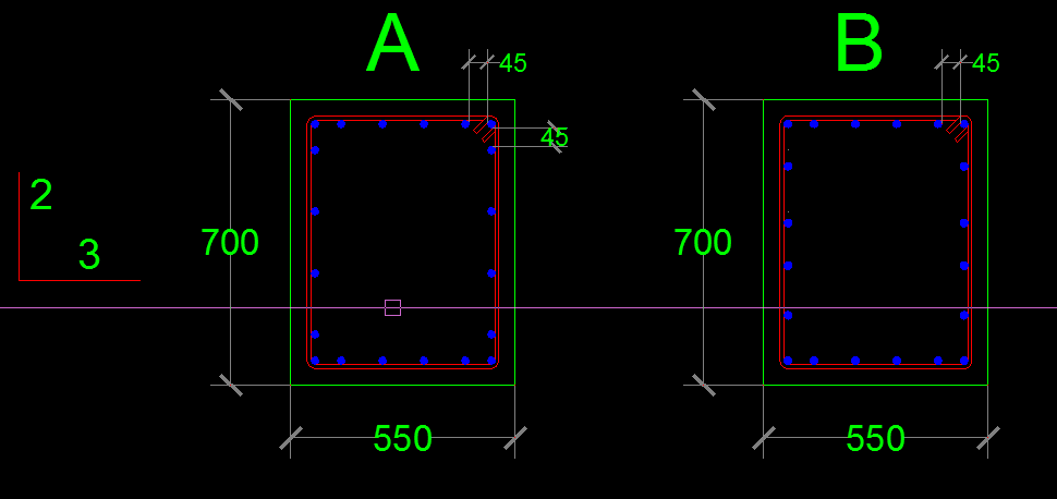

in general placement of rebar, i always see that the rebars set on the same spacing. These are 2 columns they have the same ratio of reinforcement, same dimentions, but the placement of rebar about 2 axis the A one has larger d than the B one and according to calculation its obvious that the A one gives the larger moment resistance(M3) , which one give the best overall resistance i mean not only the moment resistance but to overall ? the A one or B one?

Depends on design moment combination. Thats why i always recommend putting in the right reinforcement in columns in ETABS and put it on 'check' instead of design.
how did you model the section with different spacing of long.bar in SAP2000/ETABS? i always see that they have the same spacing bar to bar
