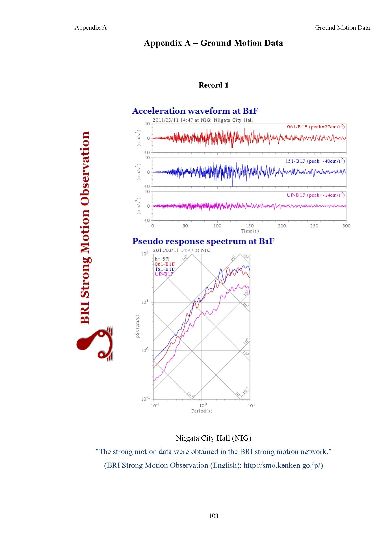

Well...following are excepts from my thesis;
You can use following databases that my instructor recommended;
"6-      I suggest that you model using time history analysis. There is different data banks where you can look for low frequency ground motions/earthquakes. Take a look into the following websites:
in the second website you will find a lot of datasets recorded from different earthquakes. I suggest you spend some time until you understand the structure of these websites and the data available there so that you can choose a number of earthquakes that you could use in your studies."
