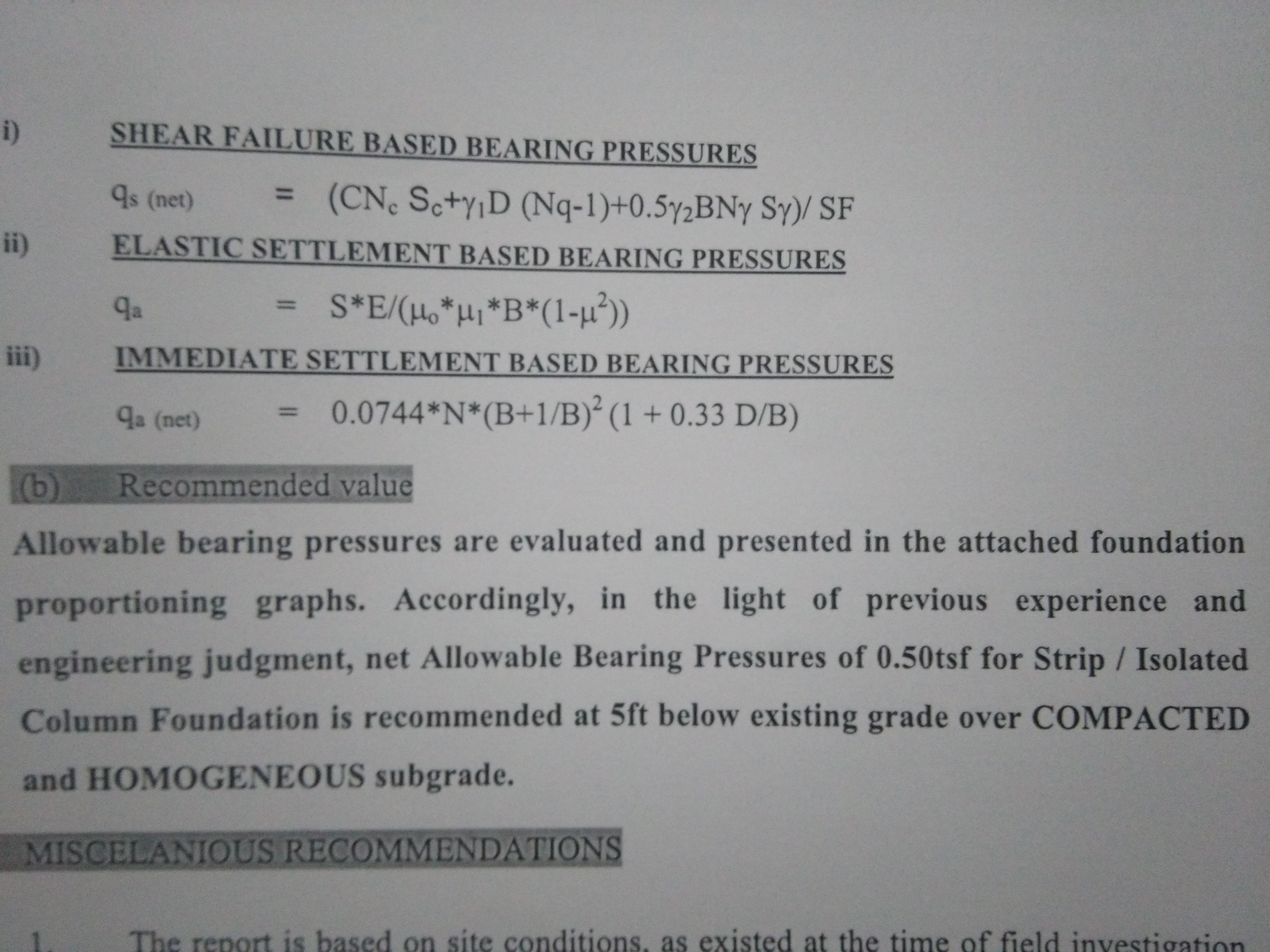

A soil investigation report stated that 0.5tonn/sq.ft is to be considered as safe bearing capacity for isolated column footing (As shown).. if instead of isolated, mat is provided, the same 0.5ton/sq.ft capacity shall be considered for mat design or it will be different ??

It should be different. The bearing capacity of soil is a function of width of foundation. I know this sounds wierd but this is from textbooks. A geotech consultant would be able to tell you how different it would be. If you can't communicate with the geotech consultant, you can use the same capacity. Should be a conservative thing to do in my opinion.

commonly raft have bearing capacity on 2in settelement , while isolated footing have bearing capacity on 1 in settlelemt, so diifinitely bearing capacity at 2in settlement would be greater than bearing capacity at 1inch settlement
