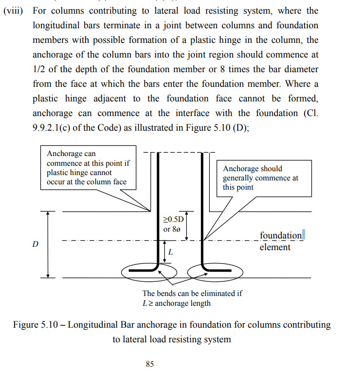

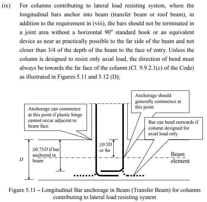

I found this useful;
https://www.housingauthority.gov.hk/tc/common/pdf/business-partnerships/resources/concrete.pdf
111.thumb.jpg.ef5bbe310685e6e1d73d2840eeb52729.jpg222.jpg.a3ec787ce08047b2d6f38b4fe3f270bb.jpg
Thanks Rana. This would be applicable for all foundations.
