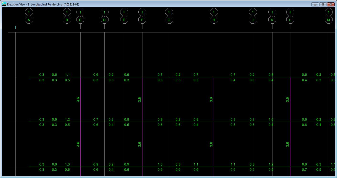

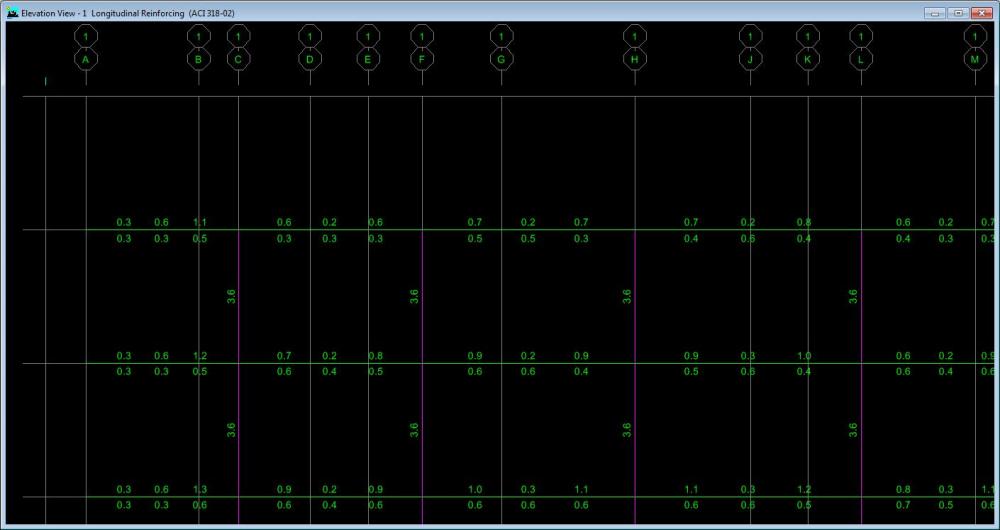

im attaching screenshot for the beams b/w grids F &H. im unable to make out the three values 0.9,0.2,0.9   and 0.6,0.6,0.4.  These values show the top and bottom reinforcement values, how to interpret these values?
Out of three reinforcement values shown along (the top or bottom side of) a beam, two outer values (0.9 & 0.9 at left & right sides of top face, and 0.6 & 0.4 at left & right sides of bottom face of the beam under discussion) indicate the amount of reinforcing steel required at the relevant (top & bottom) faces of the two supports. Whereas, the middle values (0.2 on the top, & the 0.6 on the bottom side) indicate the amount of reinforcing steel required at the mispan of the beam,  on the top & bottom faces respectively.
