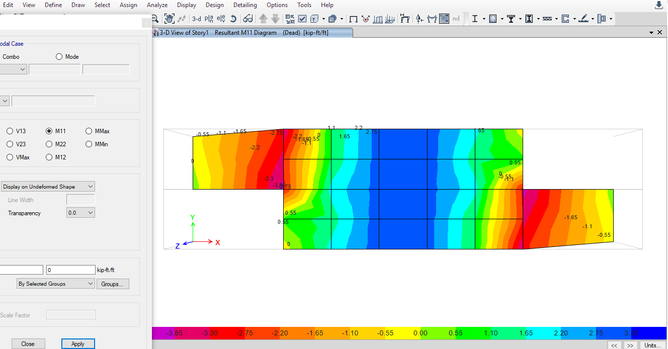

I have modelled a roof of a guard room comprising of folded plates having irregular geometry. For meshing I used Automesh option & further sub-divided it in 12inch size mesh. But, after viewing the results it was evident that the mesh in different panel was not properly connected. Does that effect the results after analyzing? Also how should I assign strips for getting the design of the folded plate from etabs? Please, share a model having folded plates in it & what is the proper way to mesh such elements? The model is attached herewith for your kind perusal. Please fix the model & share it with me.
Yes it does. For meshing it is extremely important to have regular elements and divide it in such an way so all your mesh nodes line up. I know ETABS has a feature called Auto Edge Constraints, which allows you to not worry about it. But, what I would recommend is not to use Auto Edge Constraints and do a manual mesh where the nodes line up. Your model will be free of error then. Also, another important thing to keep in mind would be making sure your  boundary conditions (the supports) are assigned correctly so that model is not unstable.
Here is the definition of Auto Edge Constraints feature:
Quote
Typically in finite element analysis, shell elements are connected to other elements at corner joints only. When an element does not frame into the corner joint of a shell element, but instead frames into the edge of the shell element, no connection exists between the element and the shell element. The ETABS auto edge constraints feature can be used to specify that elements framing into the edge of a shell element be connected to the shell element. ETABS internally takes care of connection between the elements by constraining joints lying along an edge of the shell element to move with that edge of the element.
I am not sure about strips in ETABS but you can use Section Cuts to get required forces at any location.
Update your model and let me know.
