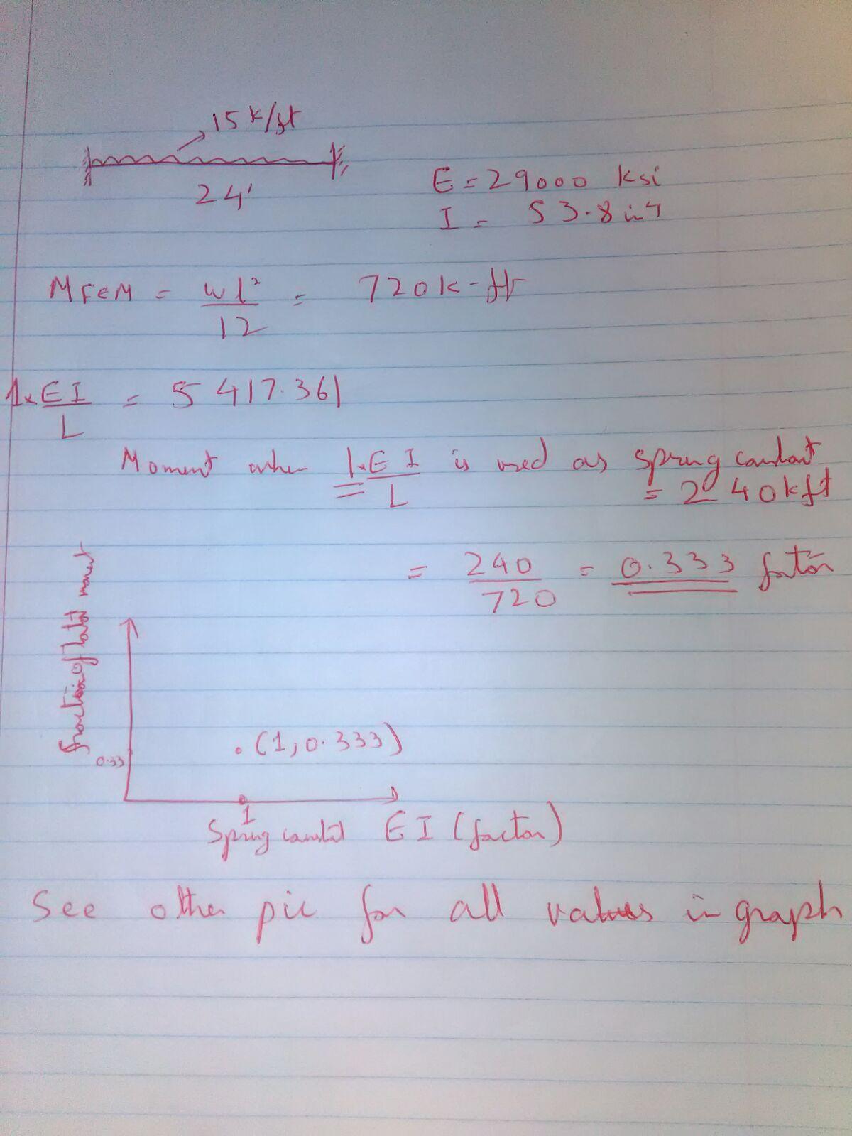

I am trying to understand how rotational spring constants work in ETABS.
I have considered 24ft long beam with 15kips udl applied so that fixed end moment is 720k-ft
I assume that spring constant will be function of EI/L. I assumed that ETABS would have linear spring, so that if I find lowest spring constant to give me 720k-ft fixed end moment, I would half that spring constant to give me half restain so that moment will be 260k-ft.

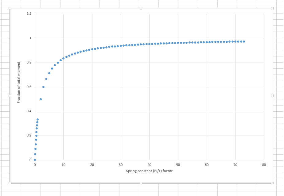

In reality results are far from it. the graph attached shows factor which I multiplied to (EI/L) to get spring constant in kip-in/rad in X axis and Y axis shows corresponding end moment/720.
Can somebody explain how etabs spring constant work so I find factors representing fraction of total restrain. 922934326_PIC1.thumb.jpg.1f0dae36d672c329a525e70a0aebde90.jpg
Thanks for your reply. Actually your blog was one of the first I studied before doing it.
I understood it now. ETABS is using equation like M=(n/(n-1))*4EI/L*theta. so rotational stifness constant k=(n/(n-1))*2EI/L. If you are reducing stiffness on both sides consider using spring constant of (n/(n-1))*2EI/L
n=% of moment to be resisted.....for n=1 we will get fully fixed, for n=0 we will get fully hinged.
The graph can be considered to be n(Y-Axis) and (n/(1-n))*2 as X axis.
