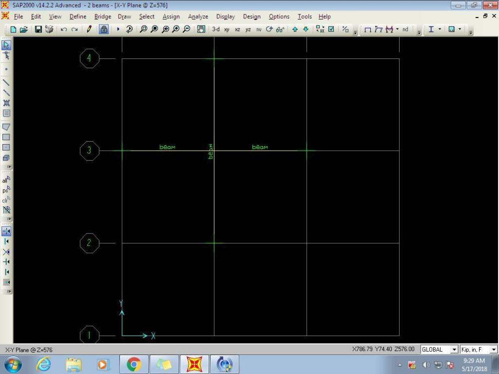

If I have two beams of same stiffness and present at same level, how can i decide which beam is supporting the other beam? What would be moment diagram look like? How to do the detailing at the mid joint? What change should be done in ETABs or SAP software?
Attached is the figure of the model
I have break one beam so the other beam should act as support but moment diagram show only positive moment for both beams.

this system is called grillage system
Khurram's repose is correct however grillage is a term used for steel frame containing beams crossing each other provided under equipment like transformers. tanks etc.
Thats because of deformation compatibility. Since both beams have equal geometric stiffness and span, both would be deflecting equally (as what happens in one way slabs where short direction attracts more load). For cases where you have identical beam cross-sections but a shorter beam intersecting a longer beam one, the shorter beam would be governing how much the longer beam would deflect. For cases, where you have a super stiff beam supporting a secondary beam (like a girder or end beam supporting a joist or secondary beam) you can provide "hanger bars". You can check out this thread for more detail:
