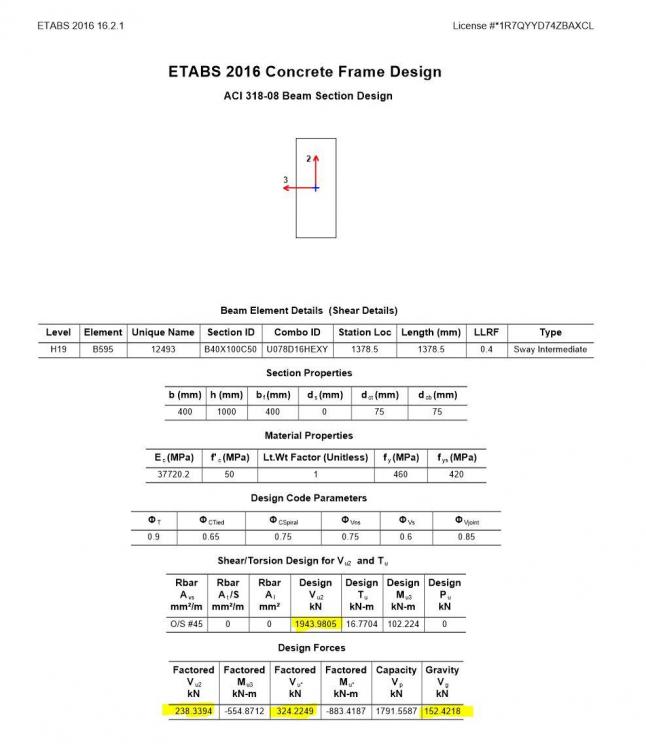

Referring to the attached snap shot, beam design output from Etab 16.2.1.
Vu2 = 238.3 ; Vu* = 324.2; Vp= 1791.5587 : Vg= 152.42
Vu2 considered in design is 1943.98 KN (which is addition of Vp (capacity) and Vg (gravity). and shows that the beam fails in shear.
Where in as per code and as said by Mr. Israr it shall be (The earthquake shear is either to be multiplied by 2 as per ACI 318-05 or the shear is to be derived from moment capacity at the ends.  The earthquake shear has to be added to the gravity shear resulting in total shear which should not exceed the ultimate shear capacity of the beam).
Any justification regarding this design results ?
You should read the beam design process in ETABS documentation for the desired code. Vp is the shear based on max probable moments at each joint. Vp will be added to gravity shear as ETABS is doing.
