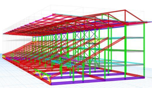

Just for refernce i have attached the model snapshot and damper i am using.

The attachment is very interesting and elaborate. Thanks for sharing that. I think you should go with the recommended iterations suggested by the vendor in the attachment. Start with an assumed U value and work your way to see if you meet the requirements. I would personally not worry about even considering the ductility of the structure when dampers are being used as ductility difference is significant.
