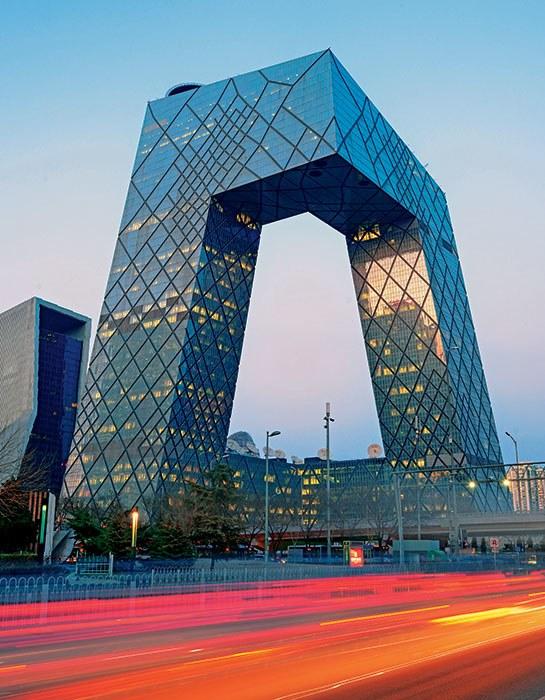

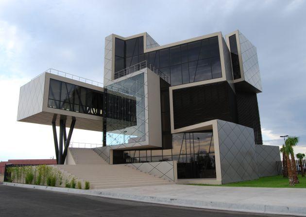

I am a civil engineer with a little experience, I have been asked by an architect to check if a building is stable or not. How can I check this?
I am not asked for detailed design or calculations, I have been asked just to check if the building is stable or not with very simple calculations, the building is a bit complex like the pictures shown.

Hi Anton,
You need to create a free body diagram and do strength and deflection checks . For that, you will need some information from the architect like building plans to estimate mass per floor and structural framing drawings to idealize your structural for hand calcs.
Depends on your material. If your material is concrete, use a concrete book that can show you the examples, to check individual beams, column for strength checks. If its steel, do it for steel. If you have access to software, that can do the same for you.
