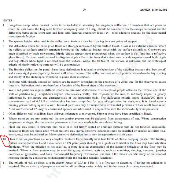

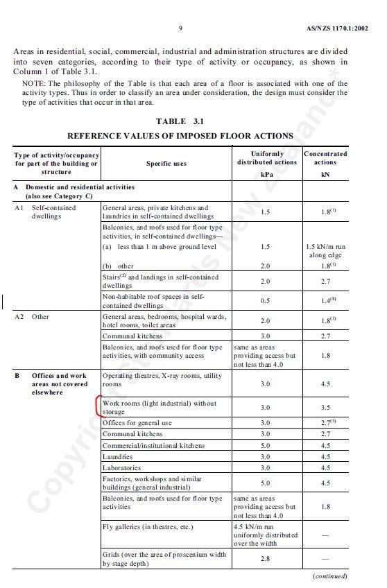

I am working with Austrailian/New Zealand codes. (AS/NZS 1170). the vibrations come under the serviceablilty requirements. If you see the table attached we use 3kN superimposed load for the design check which reduced by 0.5times for the service check for the beam vibrations. AS/NZS 1170 says that minimum 1kN load should be checked for vibration with 1 to 2mm deflection under the point load but we use 1.5kN minimum. have a read on the attached as they are self explainatory.
