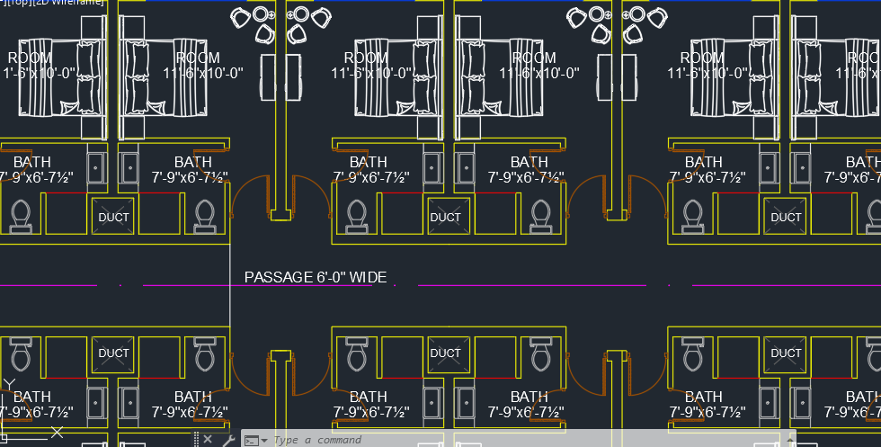

There are ducts in the building and column and beam are also passing at duct. So due to duct there is an openings in the slab at each story. Duct is NOT made of shear wall. It is a simple SMRF system. How should I detail the slab at the openings?

The part of the building has no staircase/lifts (these are present in another part of the building). These ducts are located between two bathrooms. It is kind of architectural requirement. What else I could do?

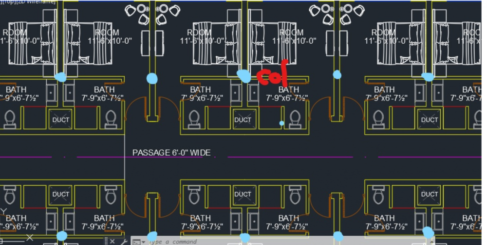

Ok, I understand the educational side- so here is my thoughts on column spacing :
Concrete frame columns are spaced normally between 6m(18ft) -8m (24ft), or even 9 m with deep or wide beams for normal rc floors. These can be lesser spacing than 6m too, if placed in wall between every room.
Therefore place your columns at the locations shown.... away from openings in slab - Thus:
Hotels often used "blade" or "rectangular" columns (600mm x 200mm - keep ration below 1:4, otherwise it becomes a wall and needs to be designed as such) so that they can be hidden within walls. So use rectangular columns rather than square ones, and they will fit inside walls, between rooms.
(My tip: PK engineering community needs to get familiar with "metric units" , especially at your early career age - writing a dimension as "1 mm", is lot easier than writing it as "0.0393700787 inch").
Hope this helps.

Can't do that either, for SMRF (have to use SMRF because seismic zone is 3, I should have clarified it before. Sorry for that) least dimension for columns is 12" (300mm). I even can't use that one because ACI Code 21.5.1 requires that the column dimension parallel to the beam reinforcement must be at least 20 times the diameter of the largest longitudinal bar in the beam. So it means if I am using #6 bar (which is very probable) in a beam then min column dimension must be 15". So column would not remain within the walls affecting the aesthetics.
I can not provide deep beams. max allowed beam depth is 2.5'. I am using column of 15"x24" and beam 15" wide of varying depths (from 1' to 2.5') even then I am facing problems of shear and torsion failures in beams. Building is 4 story btw.
Moreover if columns are in the ducts beam would also cross the duct which provide easy platform for fixture of facilities.
Decreasing column dimension posses another problem it increases (6/5) beam/column capacity ratio and steel % has to be increased to satisfy it especially in the lower stories due to seismic forces.
