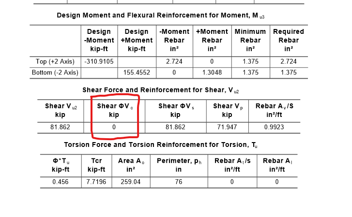

Assalaam o Alliakum Everyone,
Lately I noticed my shear reinforcement value were very high. Then I noticed that ETABs is not considering the strength of concrete in its analysis. As per my understanding phi*Vc can never be zero because shear is first resisted by concrete and extra shear by the reinforcement then how come can phi*Vc be zero? Is my understanding flawed or there is an issue with ETABs or there is another variable at work?
Any help would be much appreciated. Thank you.

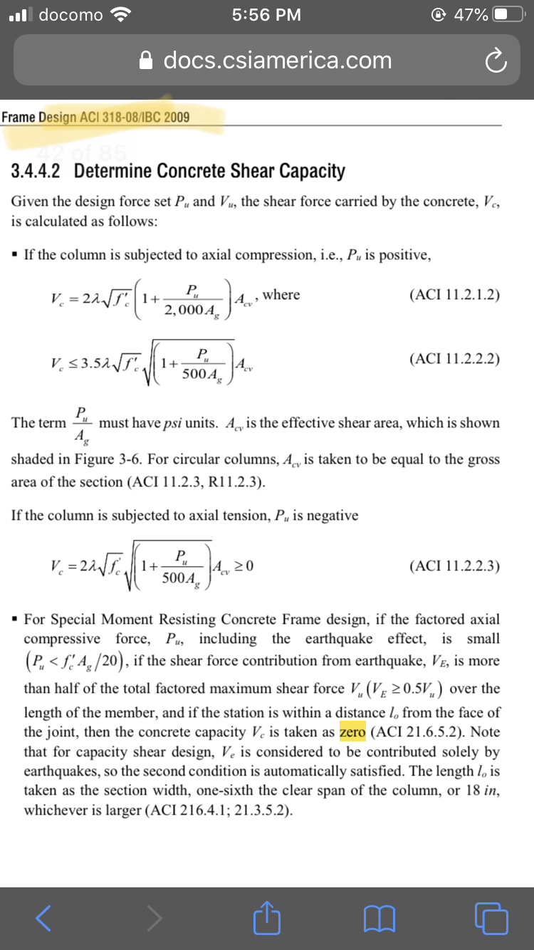

  On 6/28/2020 at 8:58 AM, UmarMakhzumi said:
Expand
Thank you for the reply.
Is it a normal problem is seismic design? How can I decrease Ve contribution to Vu (some of my beams of depth 30" have stirrups spaced 3" or 4" due to the Vc being equal to zero which is way too much.)? Is there any way to decrease it without increasing depth of beam?
Or
I just go with 3" spacing for #4 stirrup? is it practical?
  On 6/29/2020 at 9:31 AM, UmarMakhzumi said:
3” spacing is very normal for ties/ stirrups.
Expand
Thank you for the reply. By the way, I noticed if I use 3 legged #4 stirrup then spacing would be 5" and area of stirrup/foot would be lesser than when I use 2 legged #4 stirrup. That would mean a little less material. Is it common to use 3 legged stirrup? Do you advise to use 3 legged stirrup for a project in Pakistan?
