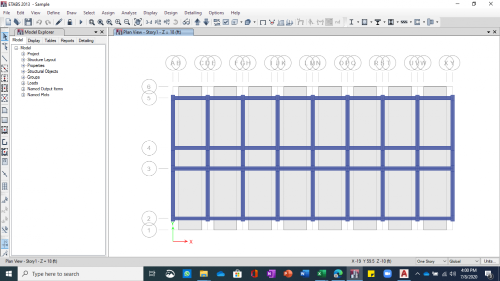

I made a model in ETABs but it had beams joined at centroid of columns as shown in the pictures below.

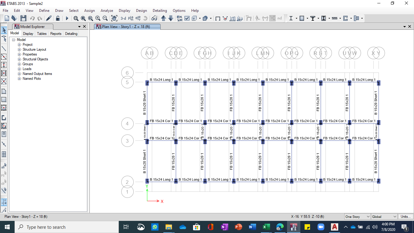

That was not the case in architectural plan. In architectural plan many beams are at edge of columns. So I used insertion point option to offset all the columns (manual offsetting causes problem in load transfer). I unchecked the "Do not transfer frame stiffness for offsets from centroid" box.1462353986_Screenshot(99).thumb.png.609603255fa3ea7b63ba04a5f53b3ee2.png

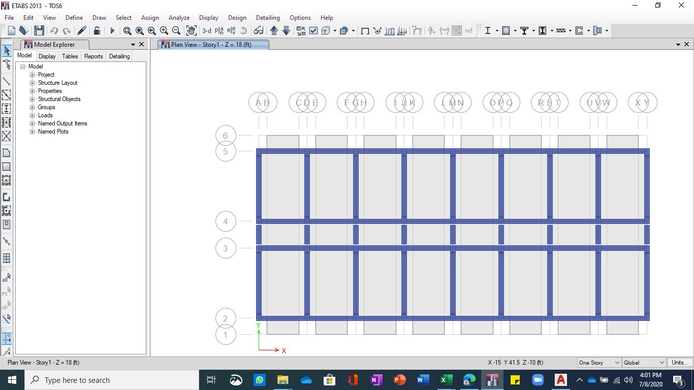

But when I extrude the frame some beams became distant from column (in the the extrude frame view only) and other penetrated the column. I then used end length offset option to adjust the beams result was this:
464316132_Screenshot(97).thumb.png.262c2940d4d2f66e0189cf386215a852.png1223530240_Screenshot(98).thumb.png.b083edec205801095f21a327de6f8466.png
Is the method explained right or wrong? Because I did not apply rigid links. Should I provide rigid links? Does the use of insertion point mitigate use of rigid links between columns and beams?
 Which one is more conservative or preferable while modelling, one with beams joined at column centroids or the one with beams at edge? Which method do you people use?
Yes, if you are using insertion points, do not use rigid links. I am more comfortable at using rigid links. Having said that, it will not make notable difference in most situations. Unless the eccentricity is more than 9 inches and there are long spans (more than 30ft).
Jazak Allah, my eccentricity is less than 9" (4.5") and beam lengths are at max 17.75'. Can you shed some light on how ETABs deal with insertion points and rigid links? I mean how these are different?
