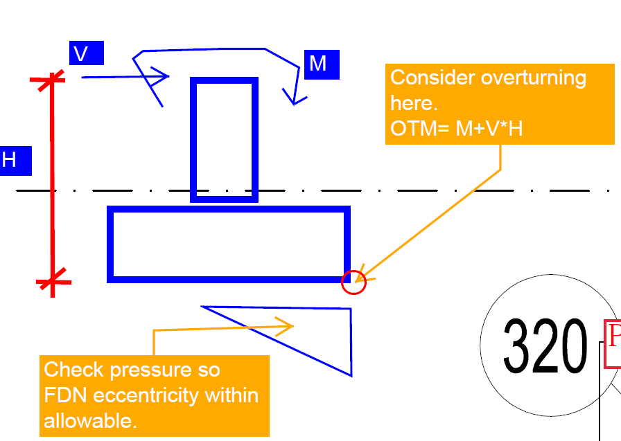

Looks like your pole foundation is a shallow (isolated) foundation resting on grade. First you need to calculate the applied loads at top of pedestal on which your pole is sitting. Then you need to check the foundation size to make sure the overturning and sliding of foundation is within the allowable limits based on the code that you are following. This will include a check in which you will check the compression/ tension couple in foundation and to make sure eccentricity is not large so that you foundation is not in tension. Such checks are provided in standard hand books. For passive pressure, see what your geotech report says. Normal practice is to ignore it.
