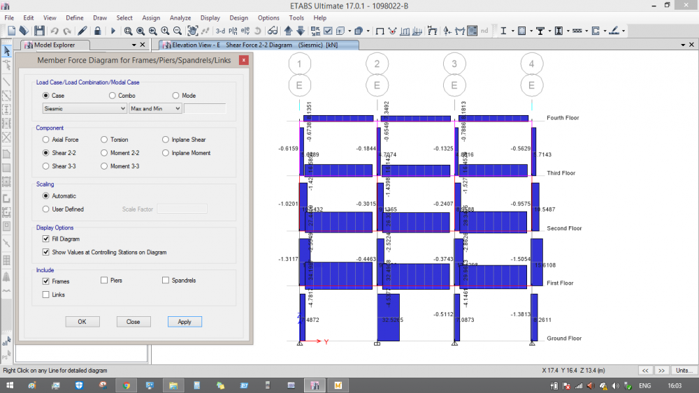

9 hours ago, UmarMakhzumi said:
Tufail,
Can you also please attach the design output summary for any beam/ column where reinfo is shown as zero?
Thank you.
I am not sure what was the error, i made another geometry and run the analyses and got the accurate results(By accurate i mean non zero at the moment). Another confusion still exists. As ETABS always check for minimum reinforcement based on Percentage (Takings start from 1 percent to 4 percent, perhaps this is ACI Limit). Is it okay to keep the sizes as per the available formworks sizes, as some time the member passes on a very little amount of Steel but the designer is not able to reduce it because of the available sizes of formwork. By changing the size to such a dimension that the contractors some time demands for modifying the drawings for making lame excuses of form work. I am newbie to designing and have no experience in dealing such kind of issues.
