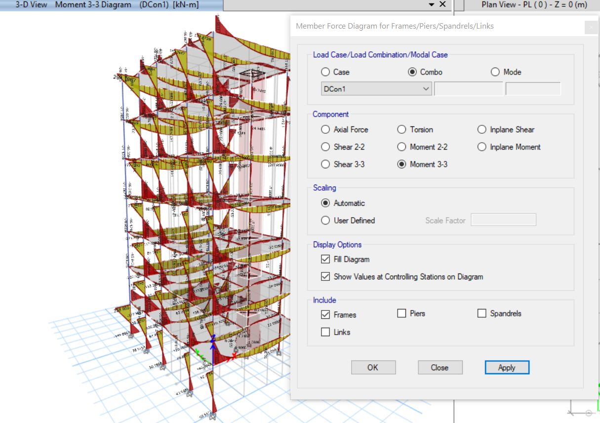

Checking Bending Moment and Shear Forces using ETABS
Omer Ahmed
Normally when we display Bending moment/ Shear Force diagram of structure in ETABS, it is shown against some specific load cases or combinations, against which case/combination we should be checking it?, for instance if I plan to calculate steel reinforcement say using Moment Diagram?        Please find attached screenshot.
Many Thanks.
