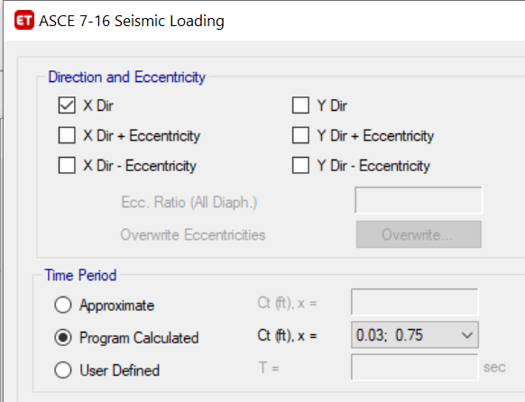

I was just looking at ACI/ASCE method for seismic design and had a general question about this new spectrum analysis method.
Quest 1 : As it says in the code to use values of (SA 0.2 sec, SA 1sec) which means generalized Time periods are taken as 0.2 for short and 1 sec for tall buildings for given site. Why these time period values are generalized? Isn't it very common for a structure to have a time period way greater than 1 sec?. How we design for buildings having more than (say) 30 stories if we restrict its time period to just 1 sec (maximum)?
Quest 2: What is difference between fundamental time period (usually varies from 0.7 to 1.X) which we find as a result, and the one we use in the ETABS seismic data (i.e. 0.030 for concrete)?
You got the wrong interpretation of the concept. These two values serve as reference points to define the shape of response spectrum.
Two approaches have been mentioned in the code for calculating the time period. One is empirical, and the other is analytical.
@waqar saleem Thanks for the answer to my first question, as for my second question what I mean to ask is how come there is too much variation for Time period in the same building?  Once, Time Period is used in Seismic Loading data (value = 0.030 for concrete structures calculated by program- FIXED value!) and then there's Time period table which we usually get as an Output ( from tables or Mode shapes)  after analysis which is way higher than 0.030 and comes out to be around 1 sec for 8 story RC building.  Are these both different time periods or the same? why there is so much difference in the values? Is "Fundamental Time Period" differ than the "Time Period"?
Thanks
