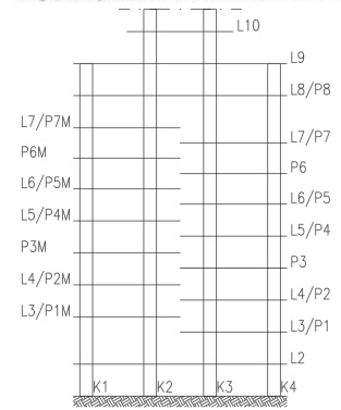

How to calculate Vertical irregularity 5a & 5b for that case? if the building have split floor shown on the picture. can i combine L7/P7M and L7/P7 compare to L8? or L7/P7M as single floor compare to L8?

I'd likely try to develop two separate lateral load resisting elements in 'both halves' of the structure and isolate the connection at the top.  How are the lateral loads resisted?  What is the height? and what is the approximate height from floor to floor?
The building framing is complex. If L2 is basements, irregularities need to be calculated for level above basement.
If you keep the framing as is, from L2 to L8 should be single story, for global structure check and for each individual tower I would do local check between each story as well. This is based on my engineering judgement. I don't have any references detailing this.
