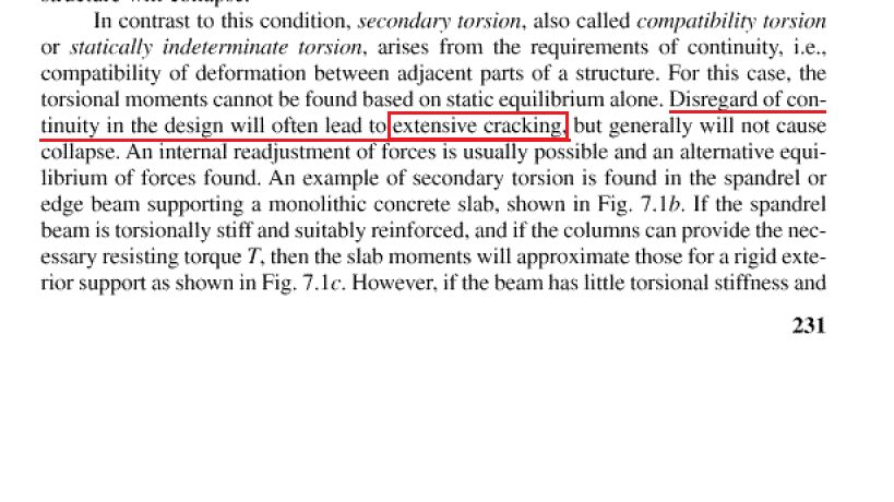

Also according to Nislon, this distribution is only possible after extensive cracking as highlighted in below pic. So I doubt the approach used to neglect torsion upto 0.001 level
What i got from the 2nd attachement of Zain Saeed the author is dividing Tcr with Tu to find how much reduction in Tu is needed to reduce torsion upto Tcr which is, as mentioned above, is necessary to keep torsional crack widths in control. and hence using the modifier for each section defined for beam. It might be a bit lengthy task to evaluate for each type of section ( most loaded members of a type of beam may be checked only), but the approach seems more realistic.
Kindly comment as I think if even we reduce to 0.001, still this redistribution in torsion is not possible without large twisting which is not possible without excessive cracking. So reucing upto such a low value does not seem good.

This is what i found in "Structural Concrete theory and Design by Nadeem Hussen"
Here it also reports the same thing that we should design for torsion for atleast
φ4λ Sqrt(fc ′) A2cp / Pcp
Which is also specified by ACI that we can reduce our torsion upto phi.Tcr i.e. cracking torsion and not below this. Even if we neglect the remaining torsion for compatibility, we should atleast perform design for phi.Tcr or should at least provide minimum longitudinal and transverse reinforcemet for torsion. This is to control crack width to satisfy servicability. ACI, Nilson and Nadeem hussen all quote the same thing.
Hence reducing the modifier upto such a little value is not good at start. At start we should go for a value of 1, 0.3 or any other suitable value which user think is small enough to release majority of compatibility torsion and will sustain only smaler torsional moments. After designing, if still some indeterminate beams are being failed, then for the specific beams we can reduce value unless we get Tu equall to phi.Tcr or a bit larger than that. Because putting Torsional modifier to 0.001 would not report any torsional reinforcement and hence adding no torsional reinforcement at all would cause excessive crack widths affecting serviceability of the structure.

When you are analyzing RCC frame members, you are concerned with flexural and shear demands in most cases, if serviceability and stability concerns have been addressed. The choice of modifier for torsional stiffness does not effect those results.
Choosing the modifier equal to 0.001 will lead to conservative results if your modelling the slab for serviceability and strength-checks.
As far as designing the beam for Tcr, in case of compatibility torsion, the code clearly directs the engineer to do that, as you have mentioned in your post..
