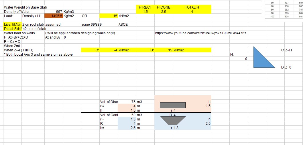

Help needed with Calc. of Water Load on Inclined slab of Mushroom type water tank
Omer Ahmed
Hi,
Can anyone tell me if the below calculation will be transposed (C and D values) for Water Load acting on Mushroom or Bottom Cone Tank.
Please see reference images for calculation (for rectangular tank) and model. Thanks.
