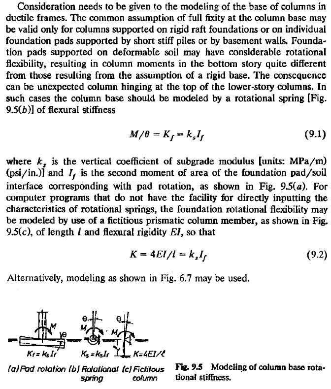

Thank you Syed for providing us with this great reference. I reviewed the book and found out that the footings are best modelled assuming a rotational spring with a stiffness of (Kf) where:
Kf = (ks)x(If)
Can you please help me in calculating the value of (If) with an example? I don't know how to calculate it.
Thank you in advance!
