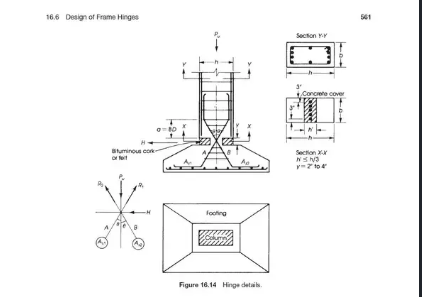

@Simple Structures Thanks for nicely explaining the concept of base fixity and I have understood all that. You are right that even in case of hinged base, the column bars are required to go straight down to the footing for bar anchorage in compression. But I have seen in many books which present the attached  reinforcement detailing (please see the attached image) of hinged column bases in which it seems that the column bars have been terminated at the face of footing and have not been developed into the footing. Your expert views on this are awaited please.
Good question - I will respond using the same numbering as previous post – read that again - thus saving me repeating the same points again.
It’s the "Hinge Detail" that you are asking about.
9. I have yet to meet an engineer who has detailed this connection in practice for concrete column in a building structure! Only place I have cross across true "pins" or "hinges" is in wooden and concrete arches. The proposed detail is not practicable for concrete fame buildings.
10. This is a very unpractical detail with very little, I would say zero, benefit. Could you construct a column like this, remove the formwork and leave it standing vertically as a cantilever, till the slab is cast? No. Therefore it’s not a buildable detail either.
11. To get a true "pin" or "hinge" with the illustration you have given to allow rotation, the connection would also require the dowel bars to be "de-bonded" and to work as true pin or hinge would require "crushing" of the reduced area of concrete, to activate the "hinge" and "pin". This then begs the question how the column compression load is transferred through the interface concrete.
12. There are no stirrups at the hinge in the detail. As hinge is supposed to move, the concrete cracks. Therefore, any water in the ground would penetrate the crack and corrode the reinforcement - inherent durability problem with the detail.
13. Let me think, the only location you could adopt the detail is when two cantilever beams meet, and the "hinge" detail is adopted to stop any relative (vertical stepping) at the detail.
Ignore the book detail, indeed cross out the detail yourself from it, if you don’t want to bin the book...it’s not a really a practical detail. Forget it.

Regarding hinge detail.. All your points seems valid "if" the construction of a hinge detail is carried out like a normal column. However, this is not how a hinge detail is designed and constructed in an rcc member. I'll give you my 2 cents on those of your points which i don't agree with (using your reference points numbering).
Although, I don't think this action will be necessary.
What's more beneficial than this that this detail will serve it's intended purpose and will not transfer any significant moment? Offcourse, there'll be some limitations such as how much load this can bear or whether this should be provided where large lateral loads are expected.
Assuming I'm providing a hinge detail in an RCC column, such as shown in the attached figure, then I'll make sure that the contractor knows about the requirements for vigilant inspection and potential stability issues, and will take preventive measure by providing adequate braces untill the upper floor/beam shuttering is removed and desired load path is achieved. Also, as far as I know, these sections are designed for a minimum accidental eccentric moment due to axial loads. Still, the tensile stresses produced due to these moments are not allowed to exceed the tensile strength of concrete.
Well actually, most of the hinges are engineered by locally reducing the size of column. This effectively reduces the moment of inertia of the cross-section which results in very small rotational stiffness and zero (or close to zero) moment from analysis.
Yes, the reduced section will cause a very high compressive stress, due to which, a very high compressive strength of concrete and bursting reinforcement may be required. The gaps might or might not  be filled later on with an elastic compressible material.
As I can see, all these provisions are considered in the picture provided by AliShan.
