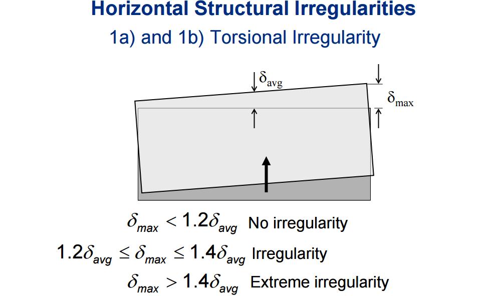

Following will clarify;
1. Load in Y Direction
Source: FEMA; https://c.ymcdn.com/sites/www.nibs.org/resource/resmgr/BSSC/Topic09-SeismicLoadAnalysis.pdf

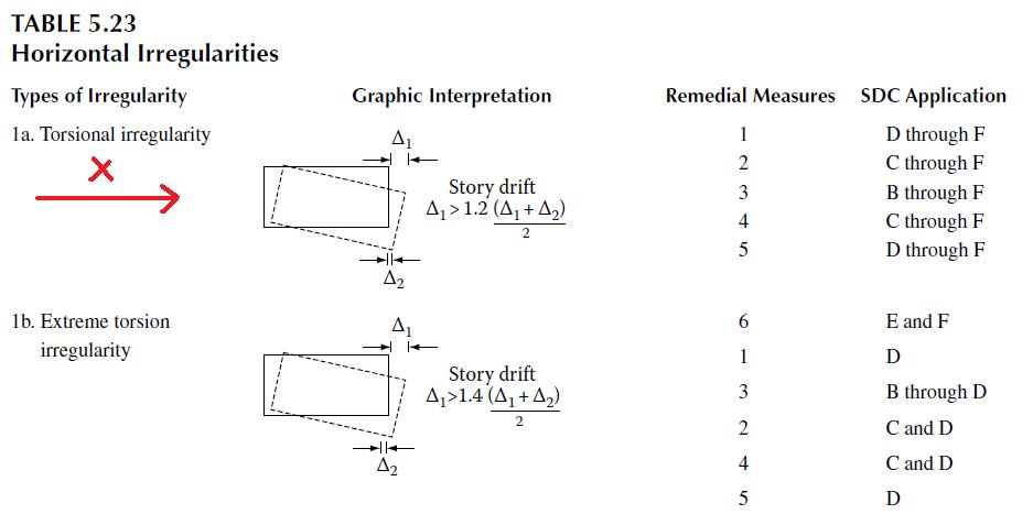

and
2. Load in X direction: Source: Reinforced Concrete Design by Tranath
