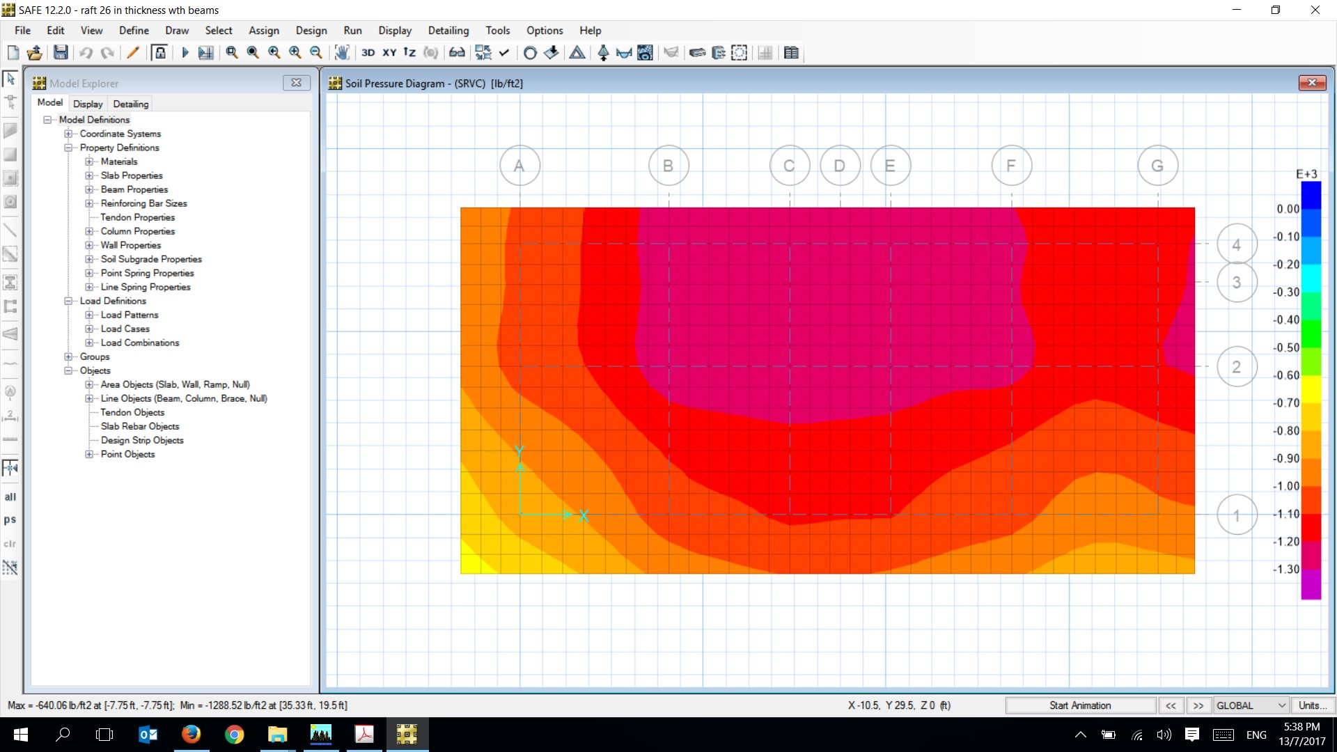

Attached is the soil pressures distribution contours. the total bearing capacity is 1102 Ib/ft2 however here the maximum value comes out to be 1288 Ib/ft2 and it is concentrated in the middle as raft is extended beyond the column lines..

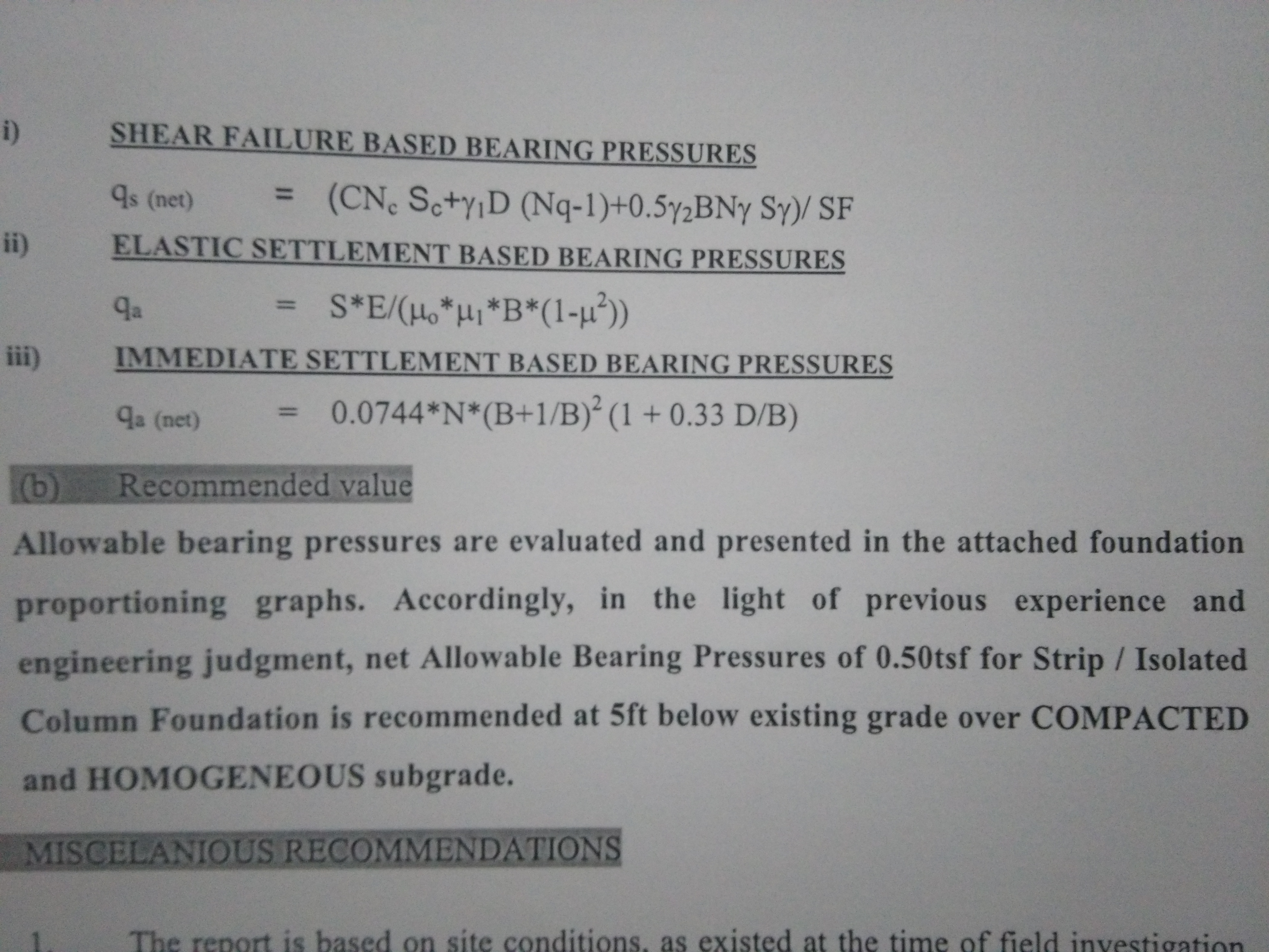

60Kpa comes out to be 1253 Ib/ft2 however the total bearing capacity is 1105 Ib/ft2 .. I have attached the soil report which states the allowable bearing pressure for the footings.. please have a look and suggest.. thanks
