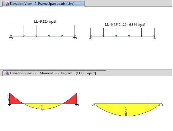

A 24 ft long, 12"X18" beam fixed at both end subjected to load of 9.125 kip/ft, yield maximum positive moment 219 kip-ft at mid span and maximum negative moment  438 kip-ft at support. But while designing at mid span Etabs is designing for 492.74 kip-ft  instead of 219 kip-ft (Image b).  Can anyone tell me why?

@Rana Please explain the Pattern Live Load Factor effect on design of beam bottom reinforcement.
On 11/8/2019 at 1:28 AM, EngrJunaid said:
Dear @Saiful Islam Zaber
Please see this link https://wiki.csiamerica.com/display/kb/Pattern+live-load+factor and the picture attached.
Hope this will suffice your query.
wouldn't the bottom design reinforcement for a continuous beam be very high/conservative than that required based on analysis, if calculated based on wl2/8 ???
1. Pattern loading (continuous beam assumed as simply supported) is used for live load only.
2. It is necessary in a real building to account for variability in loading conditions.
3. If you are trying to do just a simple beam, make pattern live load = 0
1) ETABS calculate Positive moment by taking 75% of Live load plus full dead load but my point is that if our applied live is huge like 200psf and Dead load (finishes Load+Slab self wt) is 150 and having long span of about 35ft. The positive design moment will be very much conservative because of the difference in wL2/8 and wL2/24. So if we reduce the PLLF in ETABS from 0.75 to 0.5 or less. Would this approach will be correct ?????
Thanks for your time & guidance..
