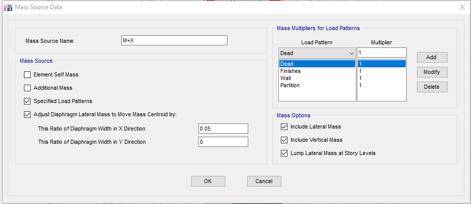

In my etab model, I have defined two grid systems; first grid at 0 degree angle and second grid inclined at 45 degree angle.
To consider eccentricity effects, I am displacing mass of the structure by 5% in x and y direction. But I am confused as to which grid system will etab displace the mass in?
Thank you for your response. Can you please elaborate how to displace the mass in both coordinate system independently? You can see the in the screenshot above etabs doesnt mention any grid system specifically.

Thank you, I understand the concept though I have another question. How to find x and y values as ratio of diaphragm width? Should I use x=y=0.03536 to get resultant of 0.05 (5% ecc acting at 45 degrees)? Or do i run the model and check some displacement values as x and y may defer due to COM & COR?
