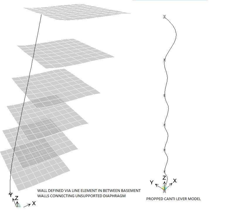

I have modeled both cases separately and have attached herewith deflected shape diagram extracted from both cases that indicates the difference in their behaviour and correspondingly in flexural forces.

post-1577-0-22594400-1411727798_thumb.jp
The deformed shape, on the left, is the one that will be required to maintain compatibility with deformations of VLRM. Wall can be proportioned for second order effects as a result of this deformed shape. But, these second order effects has to be negligible because there are much-much stiffer frames running in the direction of lateral forces, which will carry almost all of the forces due to second order effects, and you haven't included them in your model.The figure on the left is possible when second order effects are more than the effects that will arise due to retaining of soil, and in that case you are right. But if the effects of active earth-pressure are more, than the wall should be treated as continuous beam, and its behavior would be similar to the deformed shape shown on right.
I would proportion the wall  by assuming that the slab is able to provide adequate reaction.
Another point is that the critical scenario for out of plane forces for wall is passive soil resistance. One has to proportion the wall by considering it as a continuous beam, supported by diaphragms.
Having said that, accurate modeling, in this case, should involve spring-supports, not the hinge-support.
