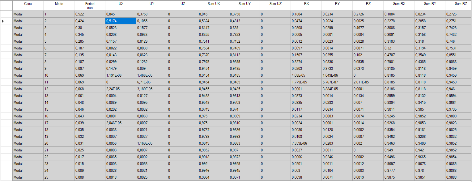

i have attached the photo of Modal mass participation Ratio of the Model, is The first mode is Torsional? As the RZ is 0.19 of the mass, and Can we allow Torsion in first mode?
and is the First or the 2nd mode is the Fundamental one?
1. Yes we can allow torsion or anything in a building as long as you are designing for that (uneconomical).
2. Fundamental mode? What is a fundamental mode? A mode with highest mass participation.
3. Why you are just looking at Rz in first mode?
From the table you attached, in my opinion;
First mode = Mode2 of ETABS with 54.56% mass participation in X direction. (T=0.553s)
Second mode = Mode3 of ETABS with 36.33% mp, rotation in Z direction (T=0.505s)
Third mode = Mode1 of ETABS with 34.75% mp in Y direction (T=0.586s)
Remember that ETABS lists mode based on descending order of T and not mass participation but in my opinion we should sort modes based on mp. Moreover, You have to check that modes are not "CLOSELY SPACED". That means, if you look at T above, you will find that translational modes (T=0.553 & 0.505s) are very close to torsional mode (T=0.586s). This is bad. Try changing configuration of your building. You can still continue designing like that but ofcourse its more economical (bad design).
From the data you provided, it looks like your building is undergoing translational+rotational in a complex way all at once. The shape, geometry, configuration of shear walls etc is not regular or you are trying to model a very stiff and very flexible elements together like a concrete basement supporting a light steel roof/canopy.
Thank you Waseem Sir, This is A four Storey Building having Basement Shear walls and Having Two Elevators Which  are not Symetric about X Axis, Will make it symetric and then will hear from you, :)

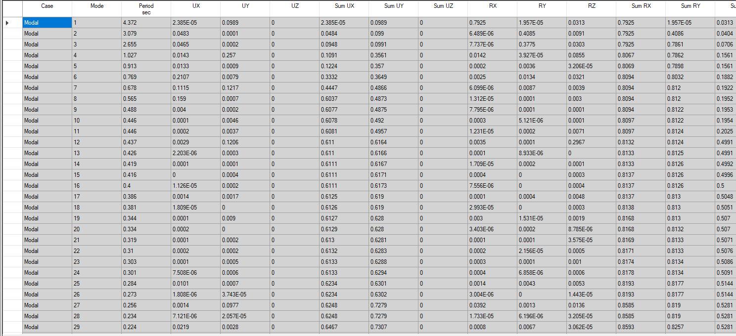

I'm having a hard time understanding this table. My supervisor said the sum of Ux Uy Uz Rx Ry Rz for the first three mode should be 100% but now it is not. Also for the first three mode there should be at least one cell from Rx Ry Rz to be a relatively large number respectively. Could anyone help me with that please!image.thumb.png.21e0950534c48ada4794d21798ae65fa.png

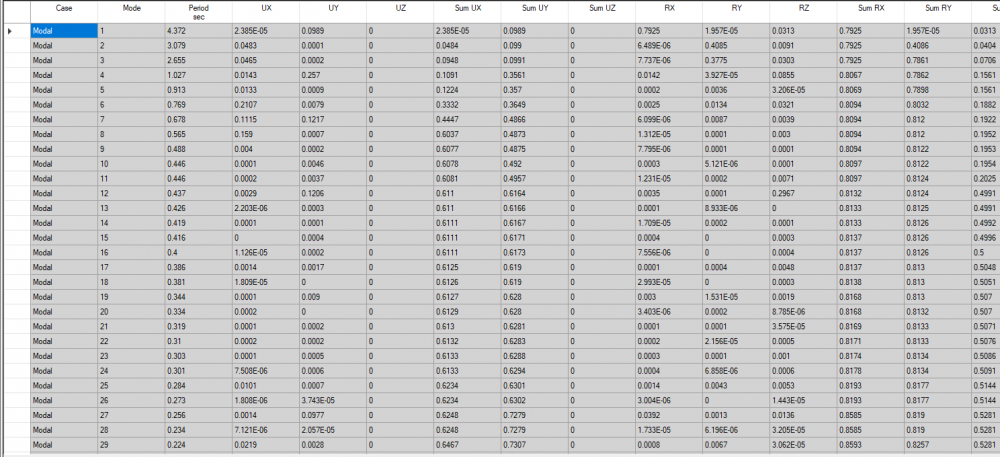

I am working on a high rise building (overall 69 stories, 10 stories of carpark, transfer slab at level 12) located in a very low seismic zone (PGA 5%g). The building first mode is translational (i considered Ux, Uy and Uz tables for this classification) and 2nd mode is torsional followed by 3rd mode again in translational.
The modal mass participation ration as shown below. I considered the default 12 modes and getting the required overall 90 percent mass participation both in X and Y direction (Sum Ux and also Sum Uy) but didnt consider the SumUz or ther SUm Rx,Ry and Rz. Is this important ???
I understand that ideally the first 2 modes should be translational followed by torsional mode and this can be achieved with proper structural distribution of elements on the floor plans however for this building the design was freeze and the design team want to proceed. After the response spectrum analysis, i showed them that the higher reinforcement in column and shear walls are resulting from this torsional behavior in 2nd mode. My question is that we have incorporated additional reinforcement tin these shear walls and columns however the slab diaphragm needs any attention ??? or any other element like designing diaphragm particularly at the transfer level to ensure that it receives this torsion and transfer safely to shear walls and columns ??
Edited by Zain Saeed
